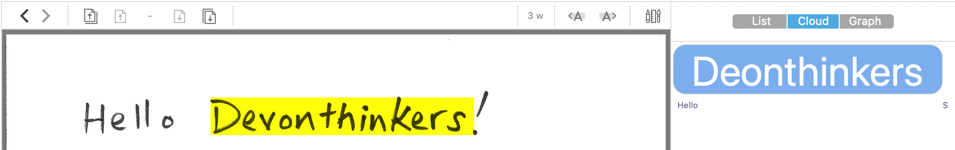

OCR on handwriting is not broadly supported in OCR engines. And the support is usually fairly strict in terms of what letterforms it can detect as characters. ABBYY’s OCR engine has some capability, but YMMV.
Here’s a simple example I just did, noting it isn’t 100%…
Of course, that could also be a best guess since DEVONthinkers isn’t an actual word.
It also detected an extraneous mark as an s.
