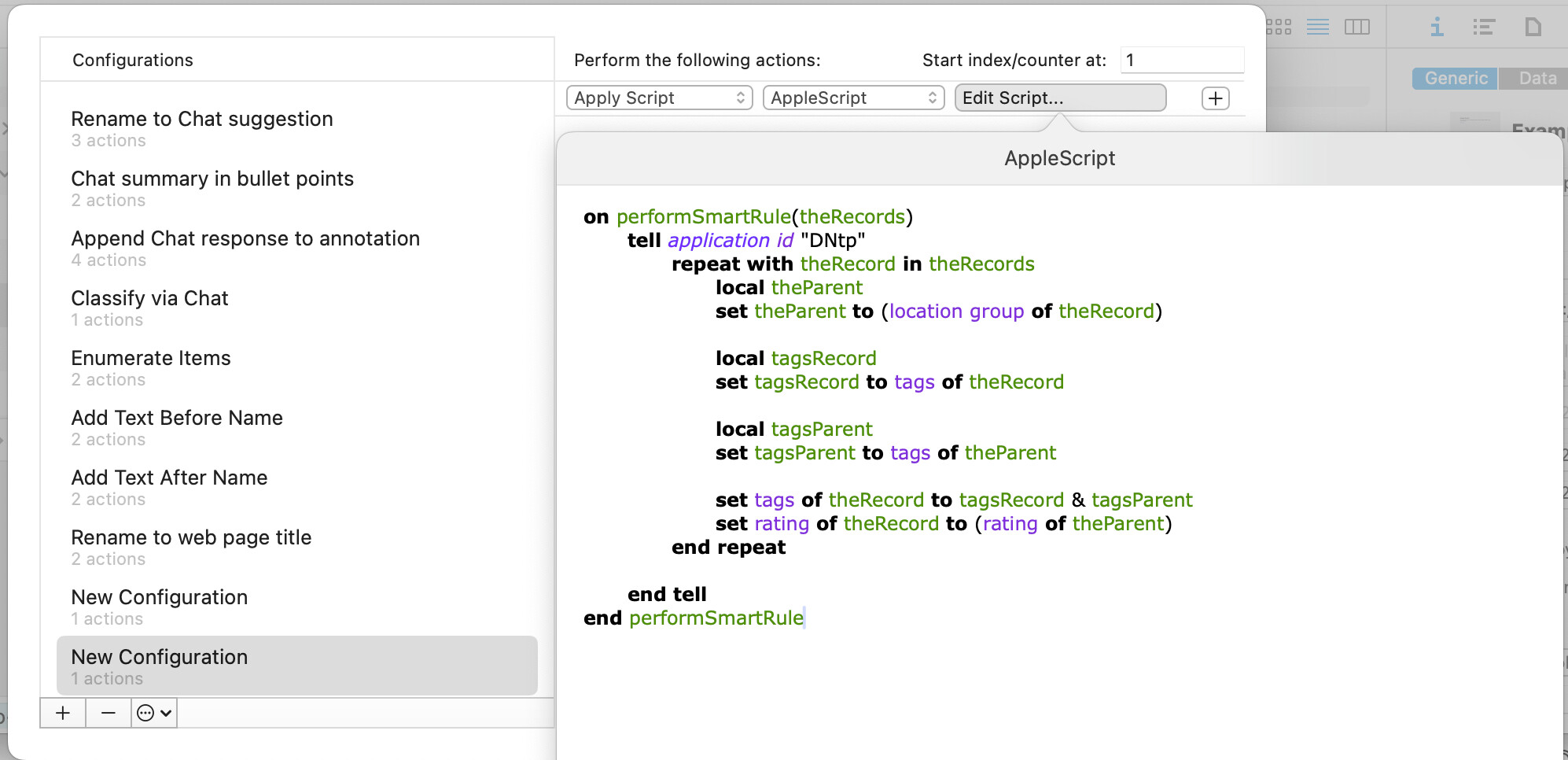

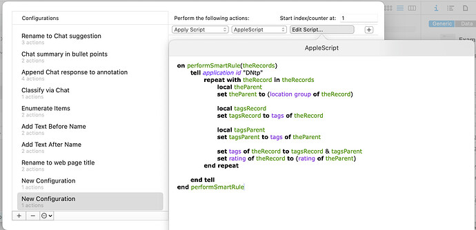

Script fails when run in batch job - on performSmartRule (Can’t get location group of content id 64221 of database id 11.)
It might be late, but I can’t see, why this script fails when run as batch job - DT 4.1.1.
When I run it as normal script within Script Debugger or Script Editor, it works fine.

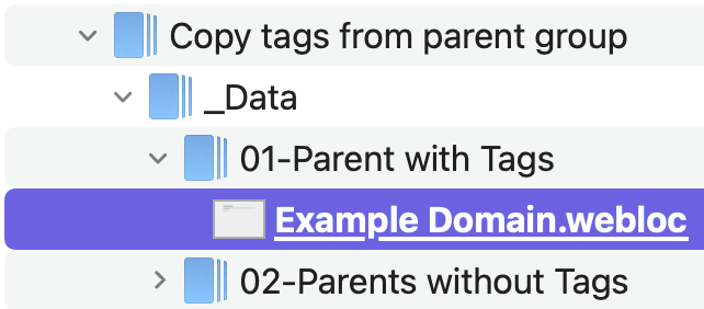

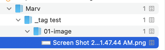

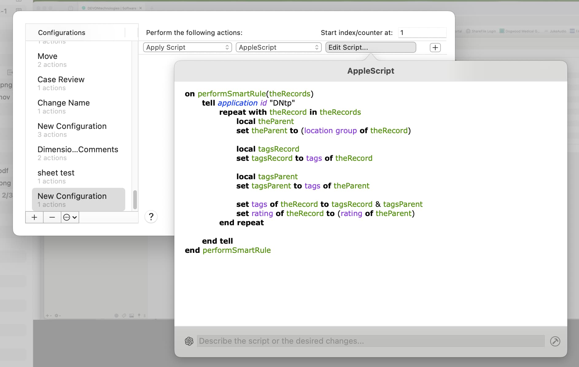

I’m not seeing any issue with your code and a group structure similar to yours…
I am curious why you’re using local variables ?
And this code is simpler and works properly…

I’m a Script Debugger user. Using local makes variables visible within the Debugger.
Unfortunately, your script failed as well.

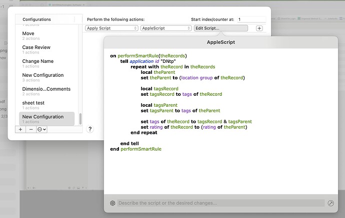

Rebooting macOS fixed the problem. :man_shrugging: I thought, that is just true for windows. Two hours for nothing. Thanks a lot for helping me out at identifying the real issue! Having a known working example as always good while troubleshooting.
Maybe something was cached by the AppleScript runner stuff, while I try to get a smart rule running using https://discourse.devontechnologies.com/t/smart-rule-fails-only-when-triggered-as-a-smart-rule-can-t-get-name-of-class-dtcn-id-1296597-of-class-dtkb-id-2/70691/28.
