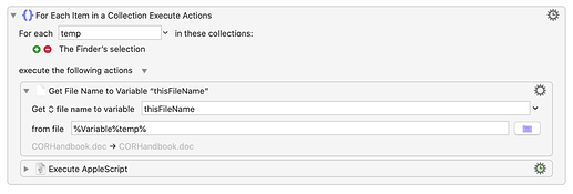

Wonder how do you even set this up in KM……
The macro is triggered from a conflict menu that appears only in Finder. The script I posted is located inside the “Execute Applescript” action in the macro shown below.
The macro loops through each selected file in a selection (the “collection”). Of course a collection can have one member – the single selected file – or multiple.
