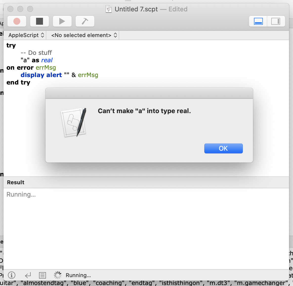

I’m seeing some odd behavior and testing right now.
Note: Your try block inhibits you from seeing an error in your code, unless you used…
try
-- Do stuff
on error errMsg
display alert "" & errMsg
end try
For example…

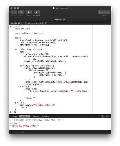

A JS approach:
Starting with the JS equivalent of a vanilla on run ... end run wrapping:
    'use strict';
    // Define what we need here
(In which 'use strict' is optional, but enables more informative messages to the user)
We could define some of the the constant values that we need:
  1. The metadata key that interests us.
  2. A reference to DEVONthink itself,
  3. and its current selection, as well as:
  4. The md prefixed version of metaData names that is used by macOS.
    'use strict';
    const myKey = 'citation';
    const
        devonThink = Application('DEVONthink 3'),
        selns = devonThink.selection(),
        mdKeyName = 'md' + myKey;
Then, if it turns out that no records are selected, we can just feed that back (for example to the Messages panel of Script Editor) and have done with it:
    'use strict';
    const
    if (selns.length > 0) {
        // Fill this out for the case where something *is* selected.
    } else {
        console.log('Nothing selected')
        return ''
If any records are selected, then we are ready to define some more of the values that we will need:
    'use strict';
    const
        const
            theRecord = selns[0],
            dictMD = theRecord.parents.at(0).customMetaData() || {},
            keyValue = dictMD[mdKeyName];
    } else {
        return ''
  1. The first selected item (JS list indexes begin at zero)
  2. The Meta Data record (key-value ‘dictionary’) of the first parent of that item, or an empty dictionary if that parent doesn’t yet have one. (In JS, or is written as || )
  3. The value (if any) for the key that interests us (e.g. mdcitation) in that dictionary.
    'use strict';
    const
        const
    } else {
        return ''
At this stage ,where AppleScript would have thrown up its hands and errored (if the parent turned out to have no value for the mdcitation key), JS just defines keyValue either:
  • as a String, if an mdcitation value was found,
  • or as the special value undefined, if there was no mdcitation value in the parent’s metadata dictionary.
In JS, is not or , is written as !==
    'use strict';
    const
        const
            dictMetaData = theRecord.parents.at(0).customMetaData() || {},
            keyValue = dictMetaData[mdKeyName];
        if (keyValue !== undefined) {
            // Expand here to make us of the citation string that was found.
        } else {
            console.log('Key not found in parent metaData: "' + mdKeyName + '"')
            return ''
    } else {
        return ''
If a string value was defined for citation, then we can pass it on from the parent to the selected child:
    'use strict';
    const
        const
            theRecord.customMetaData = Object.assign(
                theRecord.customMetaData,
                    [mdKeyName]: keyValue
            console.log(JSON.stringify(theRecord.customMetaData()))
            return keyValue
        } else {
            return ''
    } else {
        return ''
The key expression here is Object.assign, which lets us copy as many key-value pairs as we like from one dictionary to another, (or even copy them them from right to left along a list of several dictionaries).
The updated dictionary which we are defining here copies values (bottom towards top, in this layout):
Object.assign(
  • A new dictionary with just the key-value pair we want,
  • is copied up into any customMetaData that the DT record may already have,
  • but that may be undefined, if the record doesn’t yet have any meta data,
so we add a fresh empty dictionary {} at the top, as a final target, just in case.
Finally, with the meta-data inherited from the parent, we can send informative feedback,
both to the Script Editor Messages panel (using the built-in JSON stringify, which gives a readable
representation of dictionaries - often also called ‘Objects’ in JS reference materials)
and to the Script Editor Results panel:
return keyValue
This does what I’m looking for. thanks!
You’re welcome.
And as a note for peoples’ education:
A record can have more than one parent, so it needed to be specified as parent 1 of….
Cheers!
