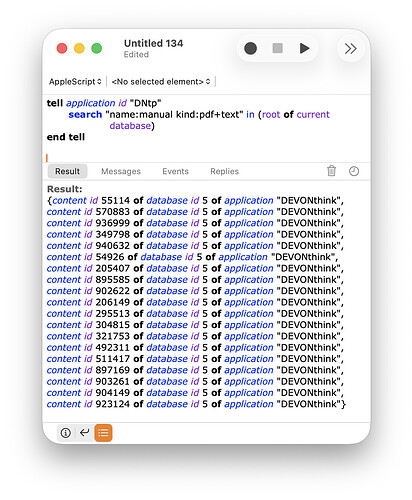

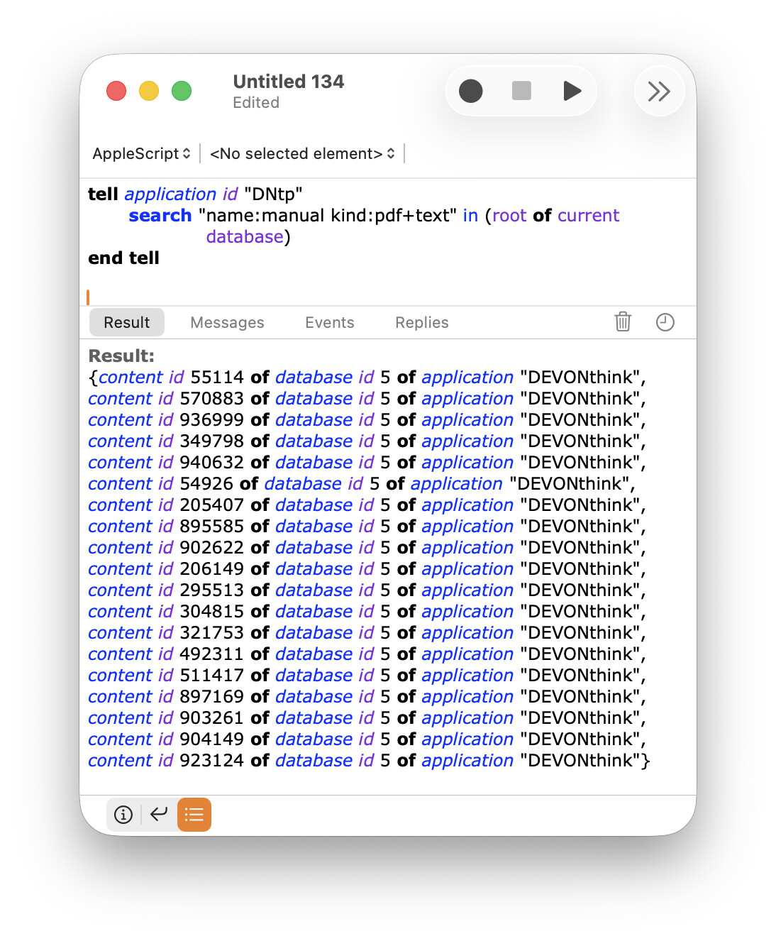

You’re misunderstanding what the script is doing. There is no fetching records here. It’s returning a list of references to the records. Then you have to walk the list, getting properties of each.
And no, it doesn’t matter if this is AppleScript versus JXA.
Querying properties of database contents works almost immediately, though you will need to process the results.

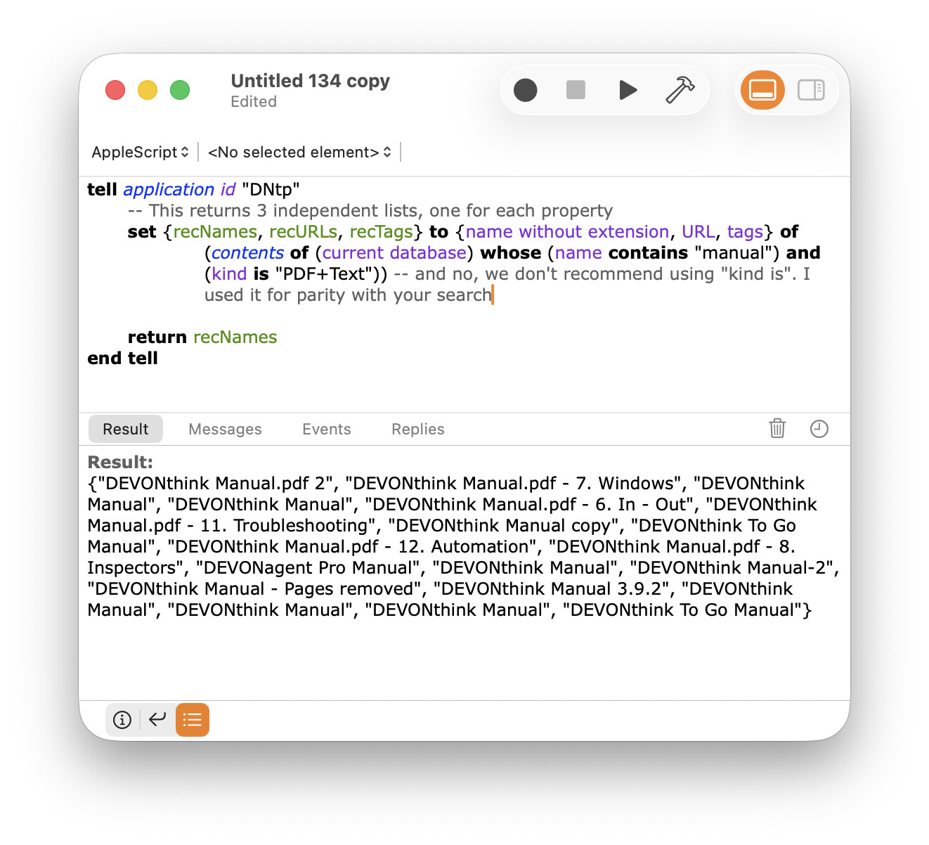

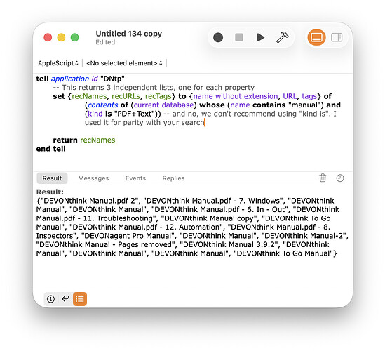

And an example per your output…
	-- This returns 3 independent lists, one for each property
	set {recNames, recURLs, recTags} to {name without extension, URL, tags} of (contents of (current database) whose (name contains "manual") and (kind is "PDF+Text")) -- Kind is NOT recommended.
	if recNames is not {} then -- A record may not have tags or a URL but it will ALWAYS have a name.
		set od to AppleScript's text item delimiters
		set jsonData to {}
		repeat with incr from 1 to recNames's length -- All the returned lists will be the same length.
			set AppleScript's text item delimiters to "; " -- Multiple tags in a list need to be separated for coercion to a string.
			set theTags to (item incr of recTags) as string
			copy {"{" & linefeed & "\"the_title\": \"" & (item incr of recNames) & "\"" & linefeed & ¬
				"\"the_url\": \"" & (item incr of recURLs) & "\"" & linefeed & ¬
				"\"the_tags\": \"" & (item incr of recTags) & "\"" & linefeed & "}" & linefeed} to end of jsonData
			set AppleScript's text item delimiters to od
		set the clipboard to (jsonData as string)
111

In general whose is blazingly fast. As is search for that matter. I’m still on macOS 15, so I haven’t experienced any speed bumps with scripting.
AFAIK, there’s no equivalent to AppleScript’s set {a, b, c} to {prop1, prop2, prop3} of expression. So, if @BLUEFROG 's code is really faster than yours in Tahoe, you should use that instead of JXA.
