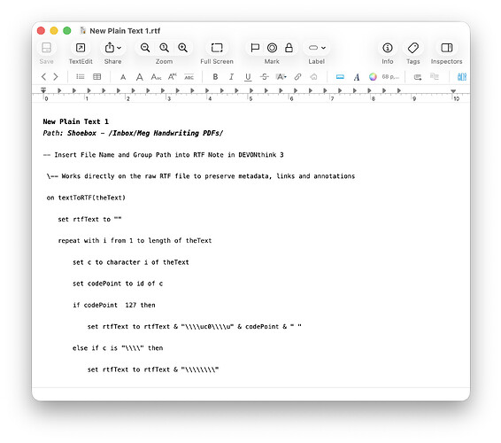

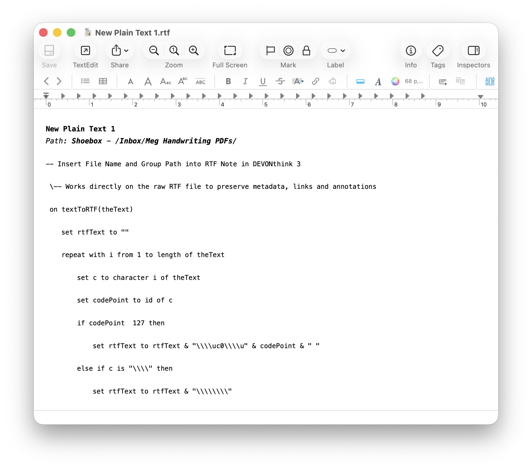

Like so…
And yes, I dressed it up a little to show how to do a bit of styling as well. :slight_smile:

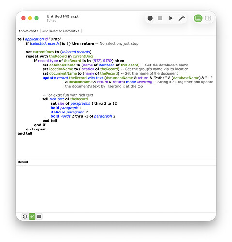

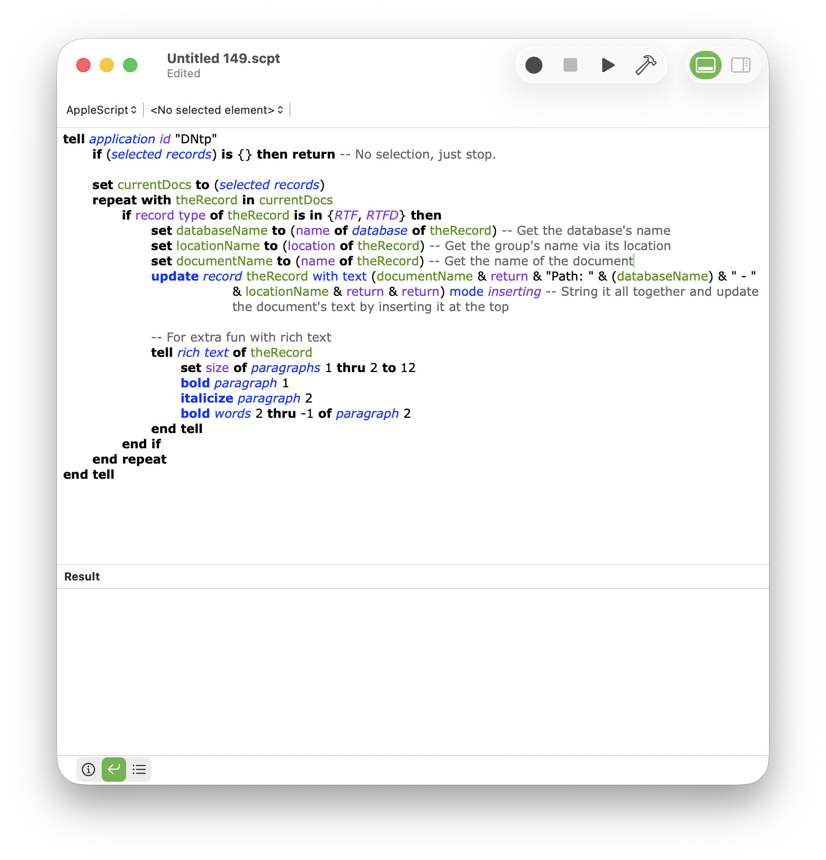

Here is the code to do this, works on multiple selected documents, and error-trapping for only rich text documents…
	if (selected records) is {} then return -- No selection, just stop.
	set currentDocs to (selected records)
	repeat with theRecord in currentDocs
		if record type of theRecord is in {RTF, RTFD} then
			set databaseName to (name of database of theRecord) -- Get the database's name
			set locationName to (location of theRecord) -- Get the group's name via its location
			set documentName to (name of theRecord) -- Get the name of the document
			update record theRecord with text (documentName & return & "Path: " & (databaseName) & " - " & locationName & return & return) mode inserting -- String it all together and update the document's text by inserting it at the top

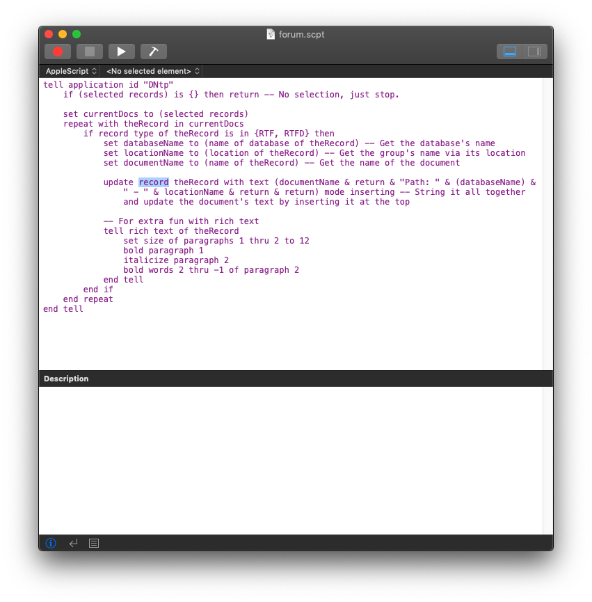

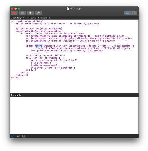

Ok, so I tried to run the script and it returned syntax error: Expected end of line, etc. but found class name.
line:
highlights: record
In Script Editor you don’t use the backticks. Those are for posting code on these forums.

Post a screen capture of Script Editor.

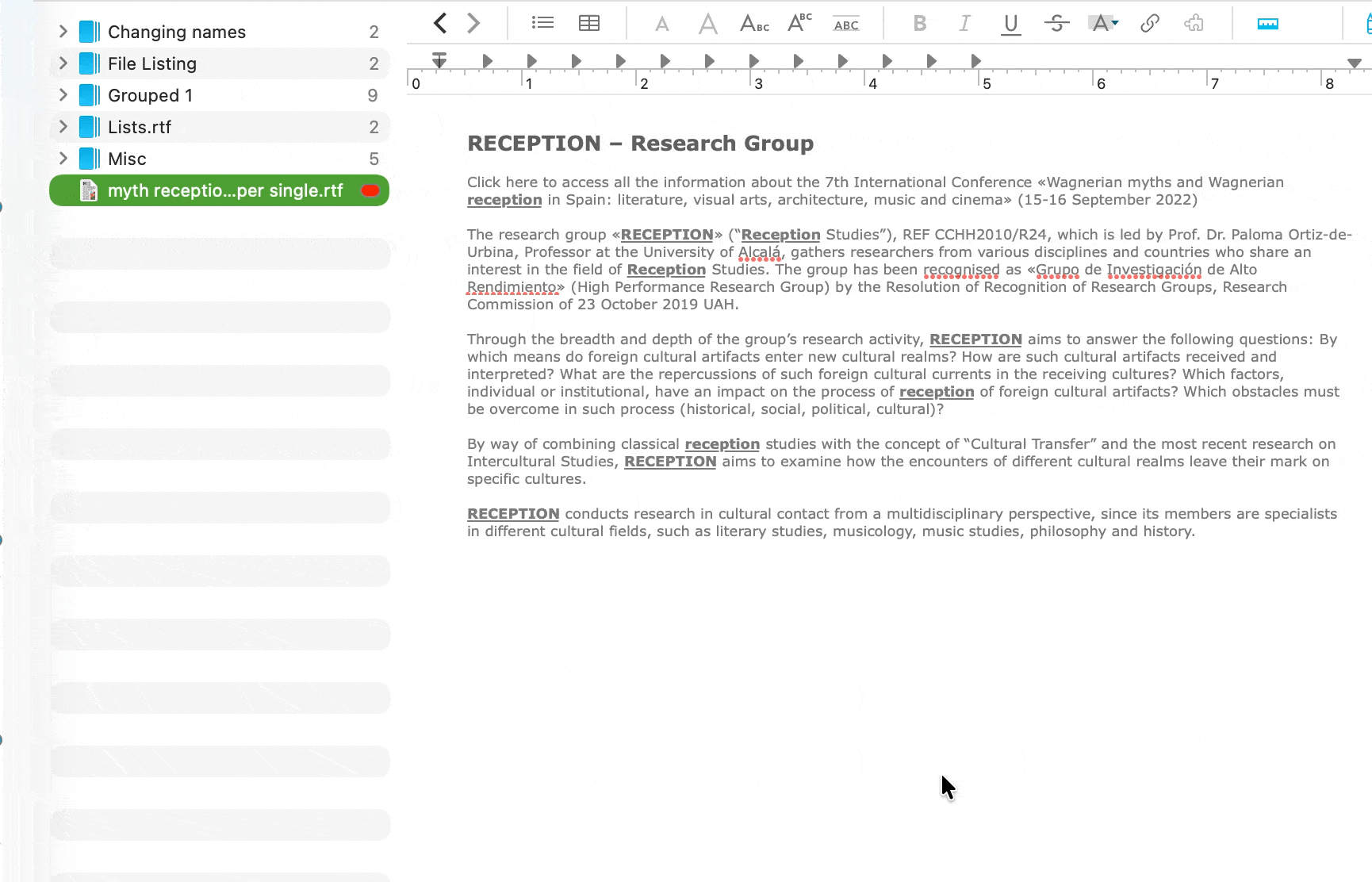

And here it is implemented in a batch process…
insert-name-and-path
Woohooooo!!! :smiley:

here is the screenshot
Ugh! Got ahead of myself… the update command is DEVONthink 4.
DEVONthink 4 is much more flexible that DEVONthink 3 but this works for the current record in version 3 and yields the same result…

Check it out @fkoutsopoulos . Select a rich text document and run it. The location should not matter.
