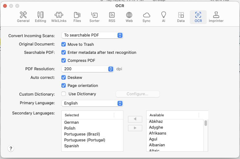

Christian, I understand that - let me ask you (and @cgrunenberg ) what does this setting mean, in the OCR settings.
I guess (!) that it’s the same setting as when you scan an image. To perform OCR, the PDF must be rendered as a raster image. And that image has a resolution.

Document controls:
- PDF Resolution: Set the desired resolution for the image layer in the PDF from 150 to 600 dpi. On M-series Macs, you can also choose As source to retain the originally scanned resolution.
(From p. 243 in the 4.1 manual, Settings > OCR)

As to @troejgaard’s find, perhaps @bluefrog or @cgrunenberg can comment on that. For example, what would “resolution” mean for a PDF that contains only drawing commands (including text), no images at all? A brief search didn’t reveal any definition of “PDF image layer”.
That’s right. There’s also a setting As Source to retain the original resolution.

As @cgrunenberg has confirmed, the setting is not about particular images.
The context here is OCR. We have a PDF, which is a set of drawing instructions (very simplified). The OCR software doesn’t give a damn about these instructions; all it cares for are pixels. So, the PDF has to be converted to a pixel image that the OCR software can understand – preferably lossless, so TIFF, PNG or GIF.
What happens behind the scenes is this, I think:
- the PDF is converted to a bitmap image, using the specified resolution
- the OCR software “reads” this image and builds text from it.
- then it outputs a PDF again, containing all the text “written” white on a white background, with the bitmap image on top.
If you feed the OCR software a bitmap image (ie TIFF, PNG, JPG, GIF etc), the first step is, of course, not necessary.
If your PDF originated from a scanner, it will only contain a bitmap image. If it was produced by software, it might already contain a text layer. But if it does not, performing OCR on it will probably remove all the original drawing commands from the PDF and leave you with just an invisible text layer under a bitmap image with a certain resolution.
