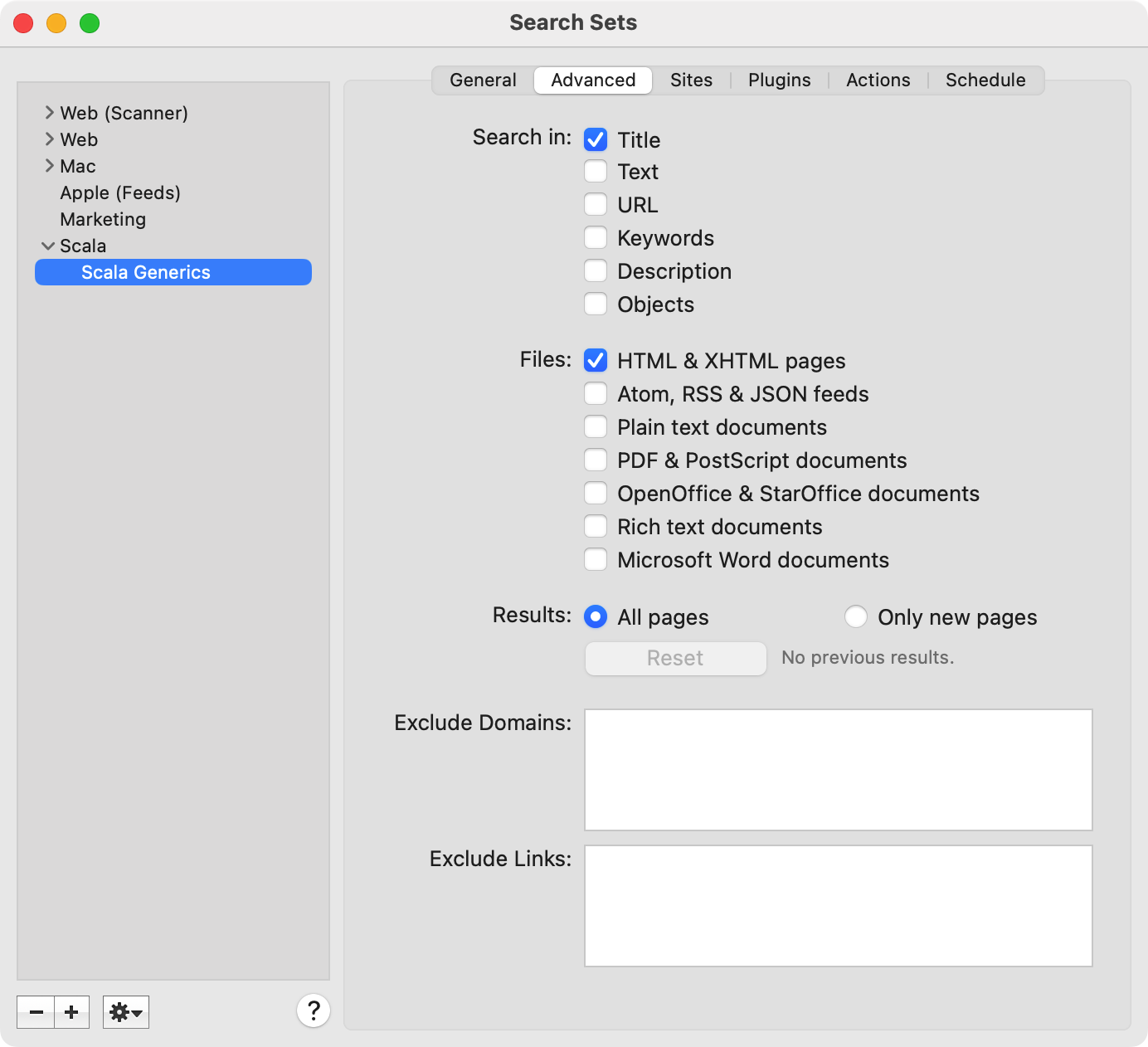

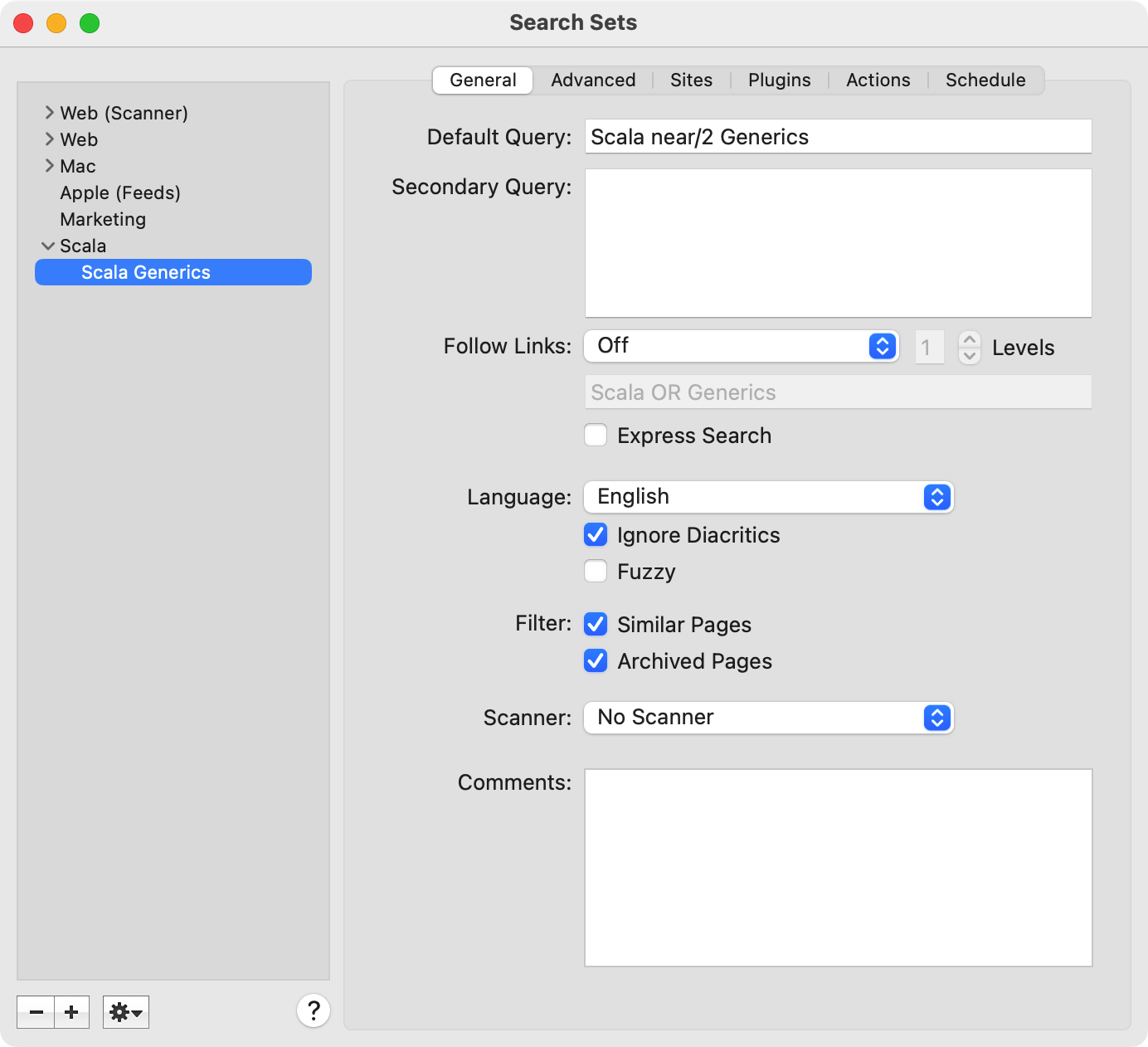

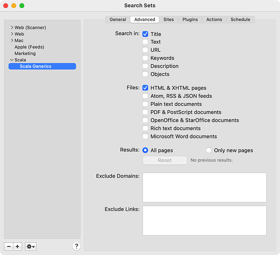

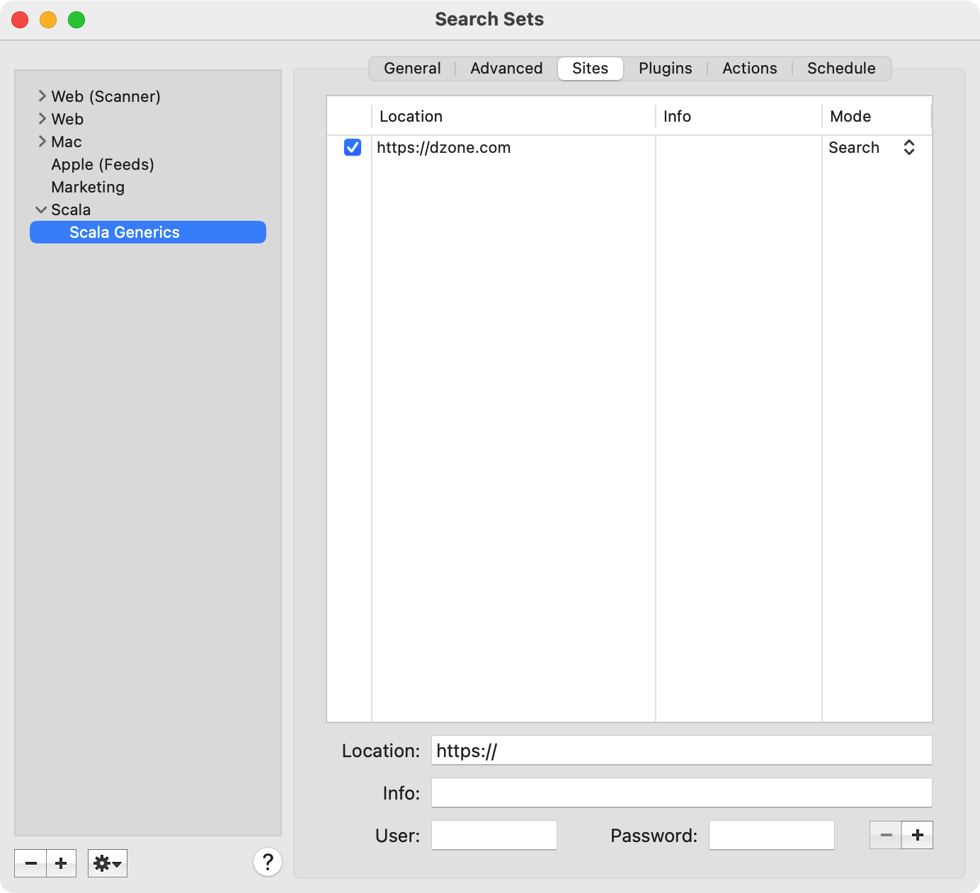

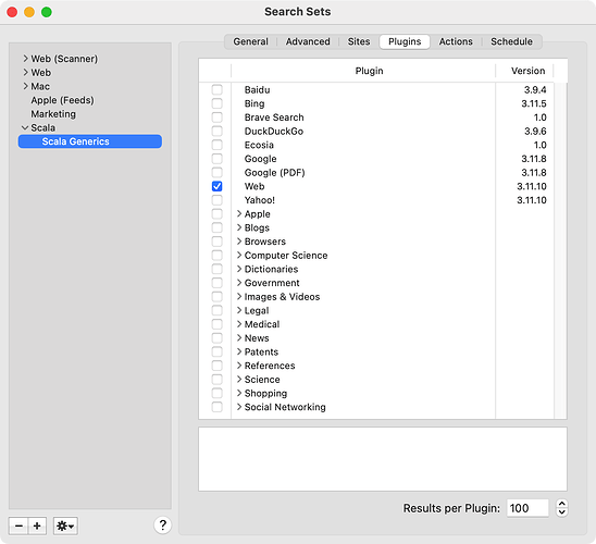

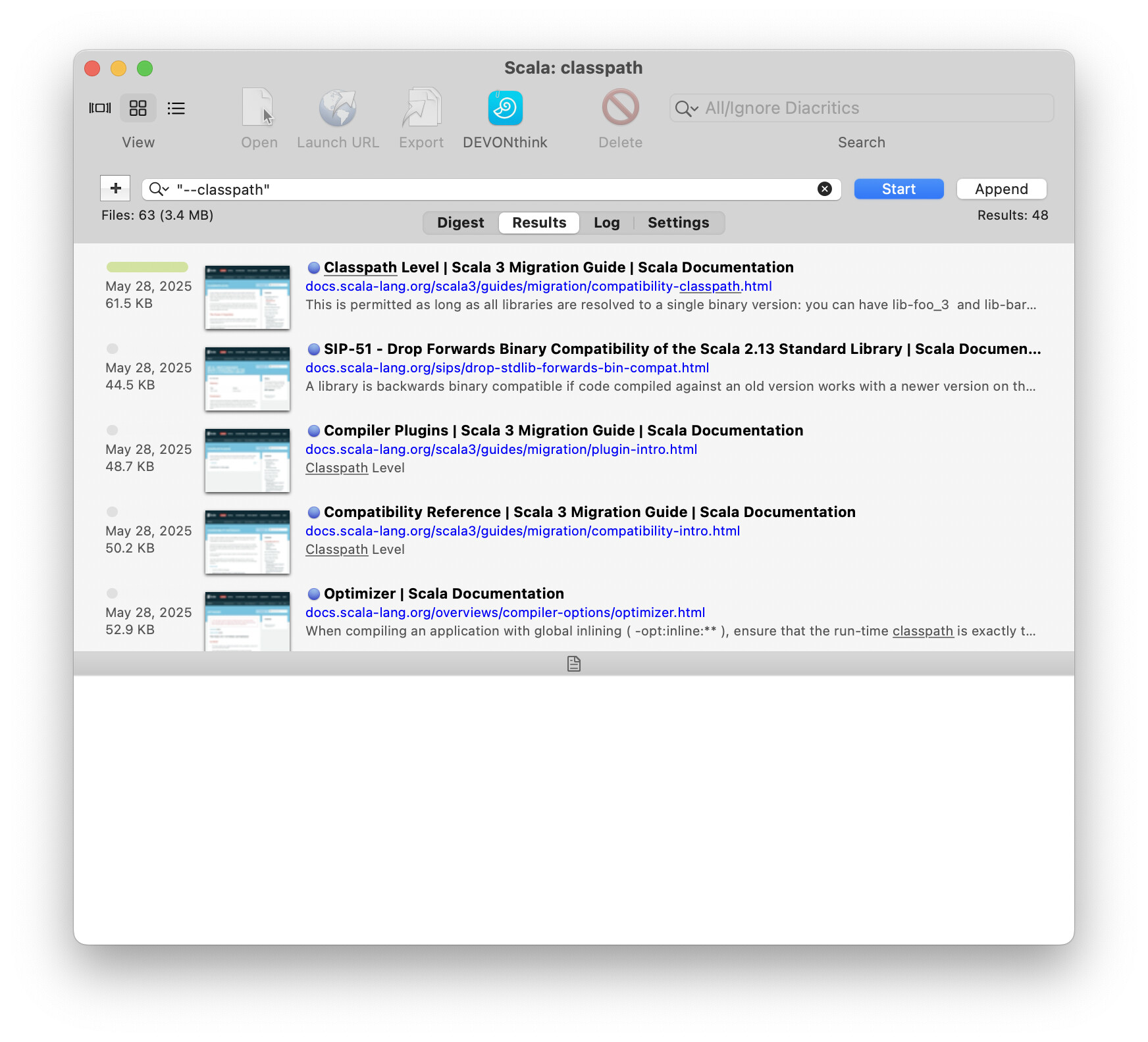

From what I understand, if I want to search for something in a single site, I have to enter that site (and only that one) in the Sites tab of the Search Set. That’s what I do. However, if I run the search according to the first four windows shown below, I get one entry for the desired site (www.dzone.com) and 11 more from other sites.

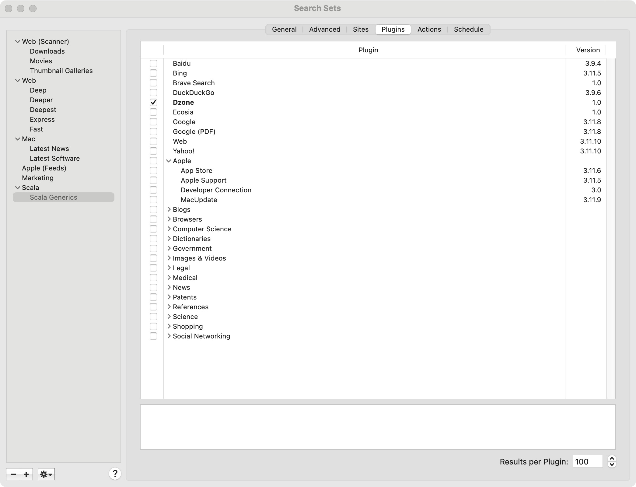

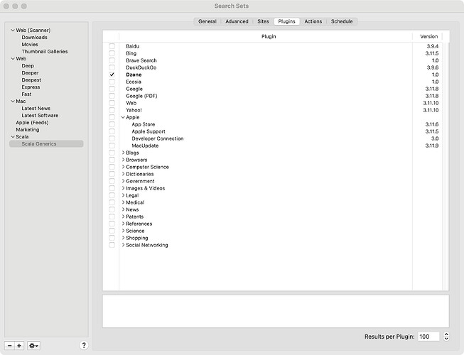

After the above, I created a plugin containing only the site’s URL (www.dzone.com). I changed the search set to contain only that plugin (i.e., I removed the Web plugin). However, in this situation, the search returns 0 results even if www.dzone.com has a page that meets the search criteria.
Is what I said above about searching in a single site correct? Is there anything extra I should do to search in a single site?

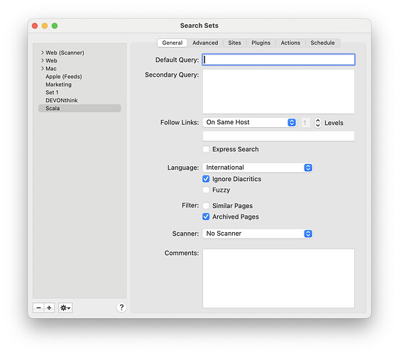

Window 5:

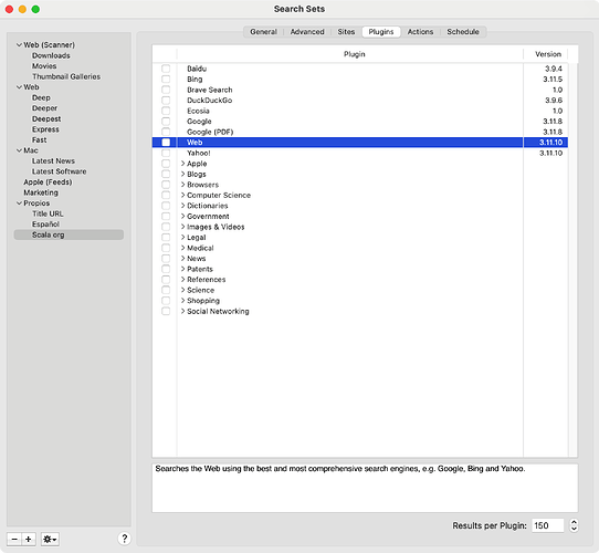

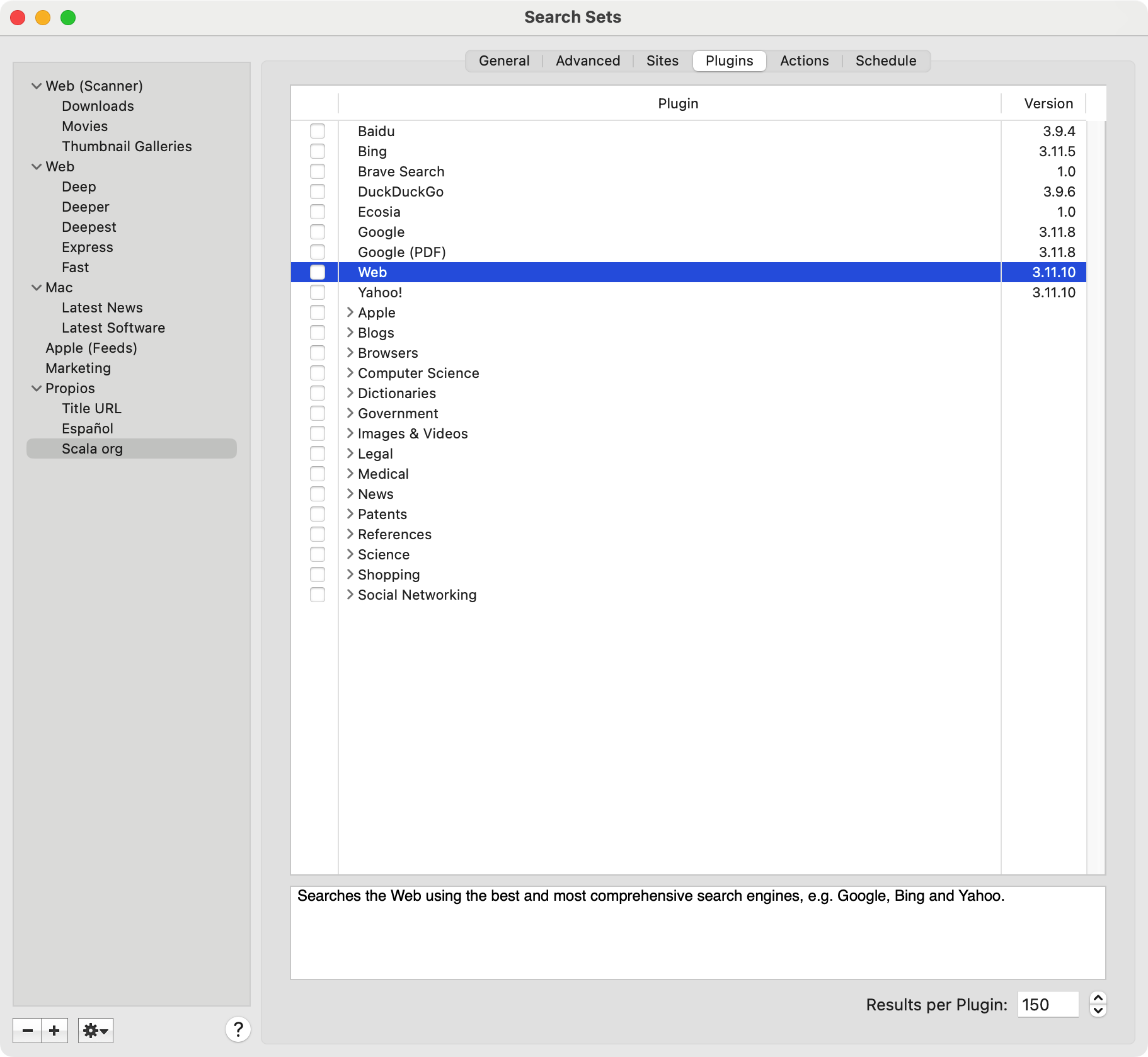

The Web plug-in was enabled initially too and this plug-in isn’t restricted to this site.
From your answer, I deduce that if I have dzone.com as the only entry in the Sites tab and Web selected in the Plugins tab, DAP will search not only in dzone.com but in some other websites too. Is my assumption correct? If this is the case, what is the purpose of the Sites tab?
On the other hand, if Web is the only selection in the Plugins tab, DAP finds a page on dzone.com. However, if I deselect Web and add my own plugin associated with dzone.com, it doesn’t find any pages. Why is this?
What I really want to know is how to make DAP search only a specific number of websites without returning results from the rest. Whether it’s just one site, as in the case I’ve outlined, or multiple sites.
To crawl or search only the specified web sites or pages. This can be used on its own or in addition to one or more plug-ins or not at all.
Therefore for your usage scenario just use only the Sites tab and disable all plug-ins.

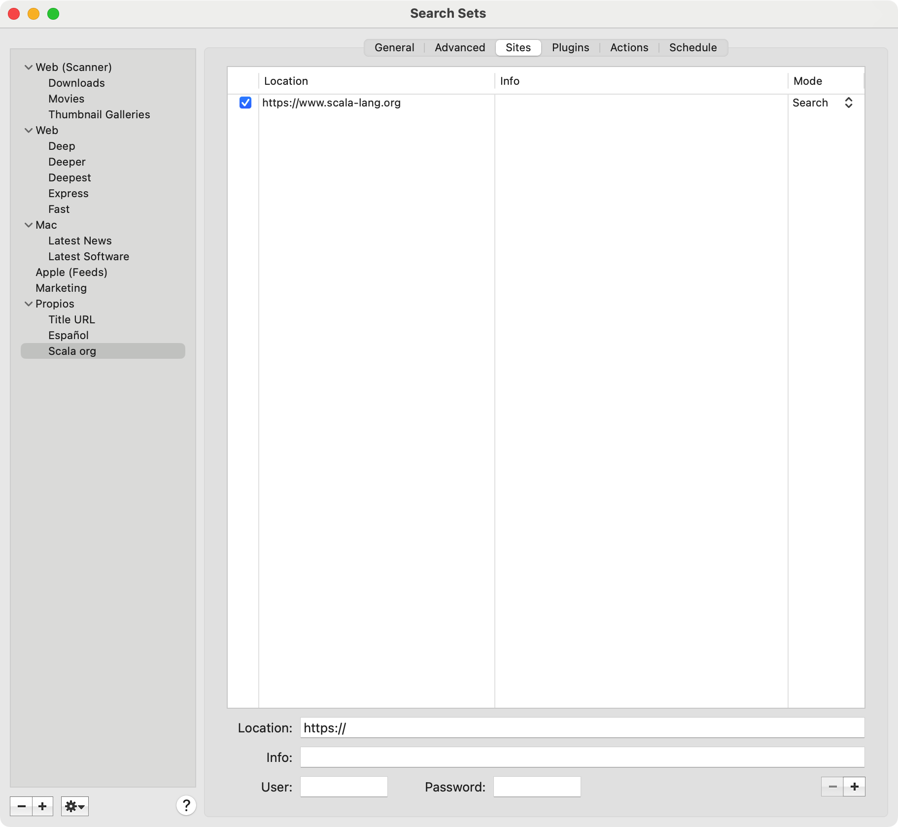

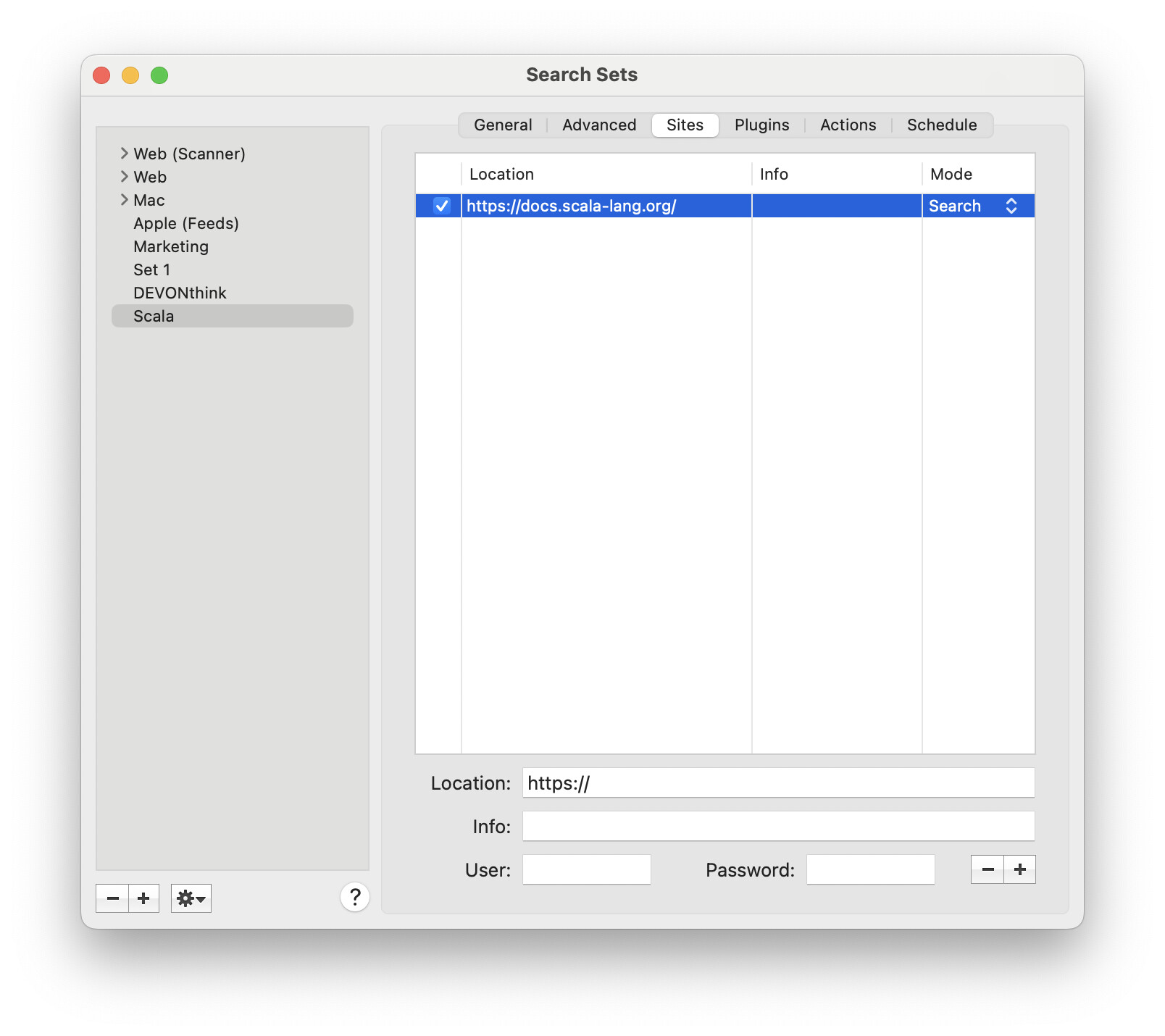

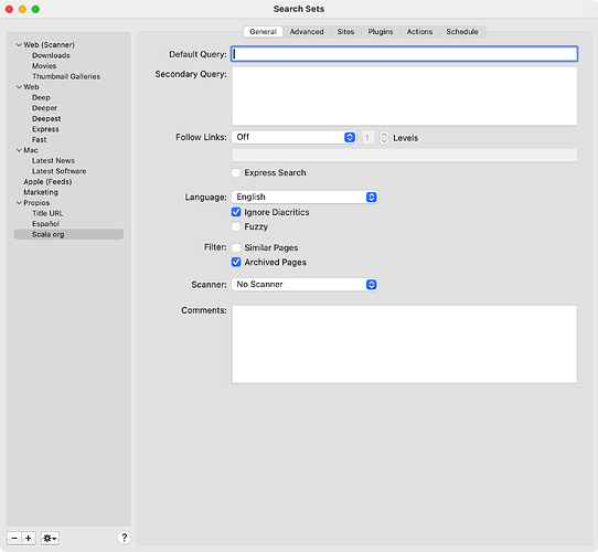

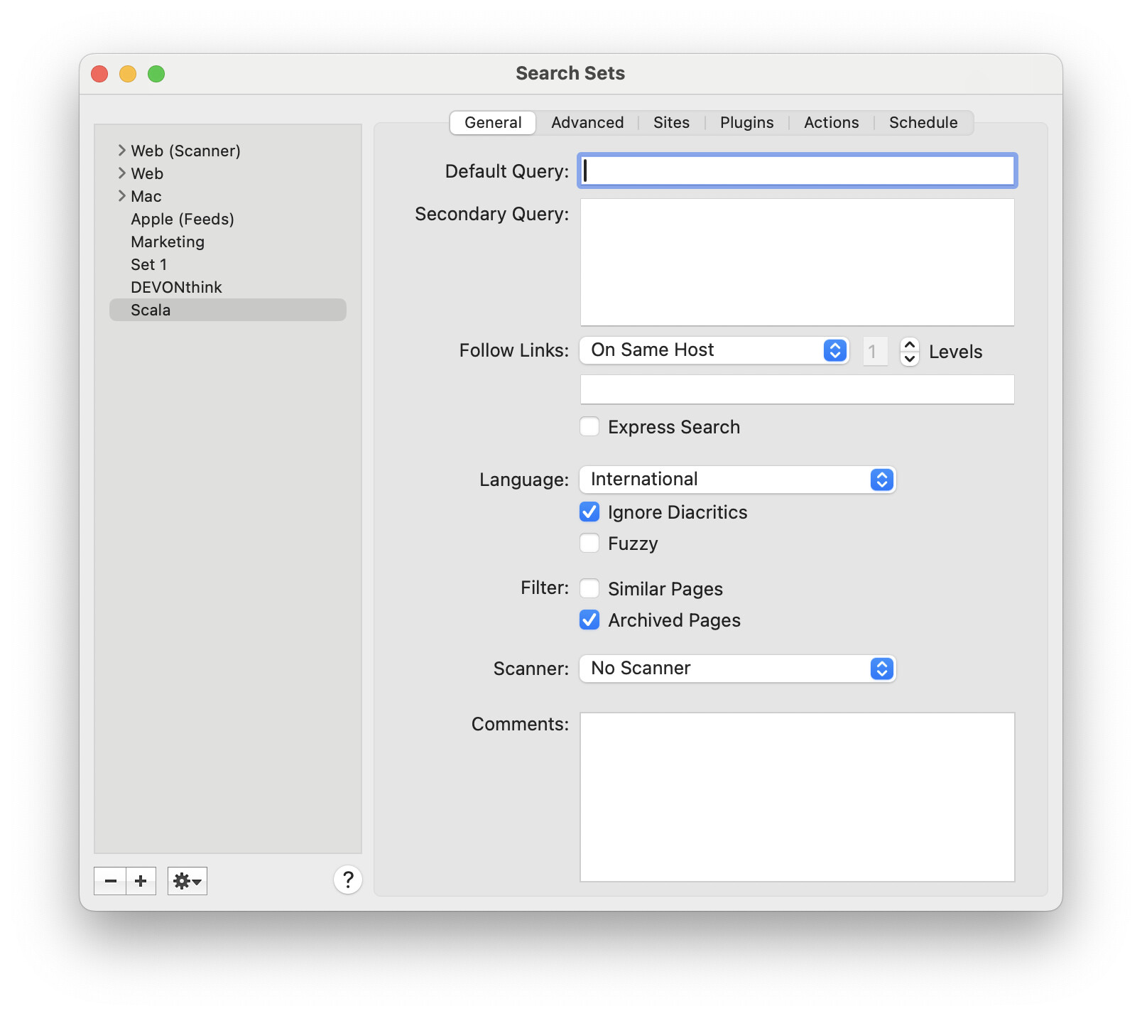

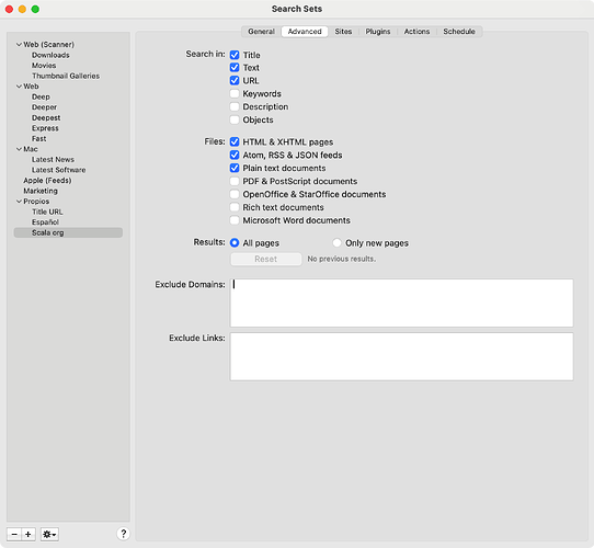

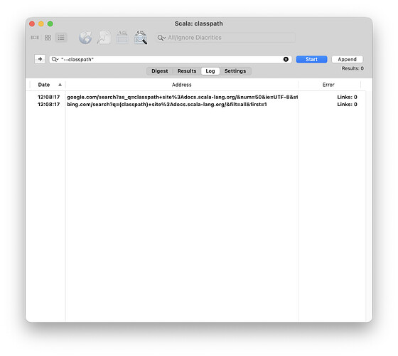

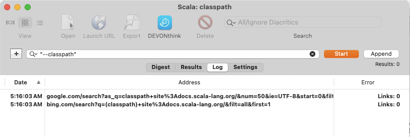

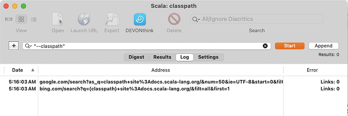

I’ve followed the guidelines you provide: in the Sites tab, I enter https://www.scala-lang.org, and in the Plugins tab, I select nothing. Every time I try a search, I get 0 results. DAP doesn’t even attempt to search; as soon as I press the Start button, the results window appears with the 0 results mentioned.
Obviously, I’m missing something, but I can’t figure out what it is
Which search term did you use?

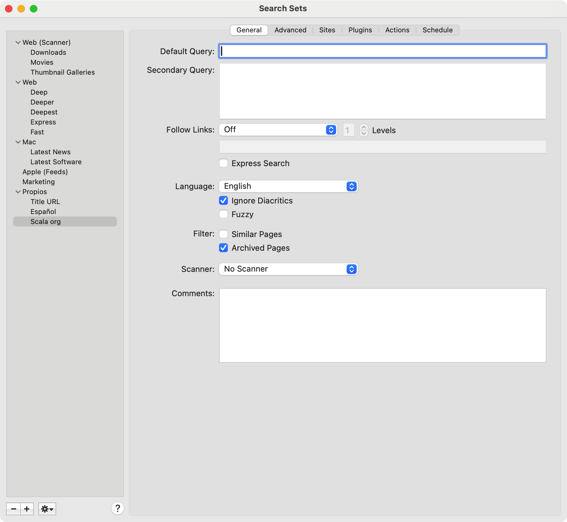

Several different ones. First, I did a search with only one word, for instance, class, object, Scala, … and then something a little more complicated like bounds for type variables, …
Scala.agentSet.zip (910 Bytes)
I just read this reply and the first thing I did was to run again the queries that failed yesterday. They worked today!!! I haven’t changed anything. I assume it was an internal issue since, as I mentioned before, DAP wasn’t even trying to search. After clicking the Start button, it simply said there were 0 matches.
I downloaded your Search Set and it was exactly the same as mine.
Thank you very much for the help. It was efficient and quick.
I’m also new to DEVONagent and had a similar problem. When I used the same Search Set and the same keywords, I got results 0. Why?
The next maintenance release will update the support for Bing but Google seems to be basically unusable now (due to requiring JavaScript and blocking automated requests in various ways).
I cannot get sites (no plugins) to work either. I found this thread and downloaded Bullfrog’s file and again get no resutls
