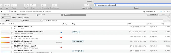

You can’t create smart grops that search other smart groups. However, you can search a smart group by selecting the smart group in the Navigate sidebar, entering search terms in the toolbar search, and setting the scope to the selected smart group.
