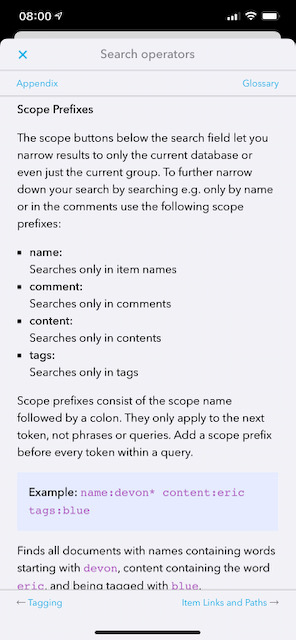

Does the order of the Scope Prefixes matter when they’re used in a search? Is that documented anywhere?
I’ve done searches for; tags:x-t2 content:power
and received zero results. However, if I do content:power tags:x-t2
, I get the exact results that I was expecting.

If you don’t press the Search button, there is an assumed asterisk wildcard at the end of the last term. Once you commit the search, the asterisk is removed and all terms are treated as words.
You could have used the AND operator… name:xt-2 AND fuji*
to find the file. Notice I used the explicit asterisk so I’d be sure to find the file, even if I pressed Search.
