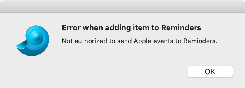

I tried the DT3 script to add an item to Apple Reminders
I get this error:
I believe my Security settings should permit this. What else am I missing?
Interestingly this is on macOS 10.14.6.

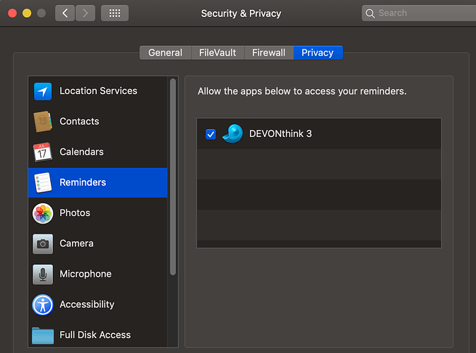

My other Mac is running macOS 10.14. There the script DOES work. The security config there is a bit different however:
whereas on 10.14.6 (where the script does not work) there is no option to add Devonthink to Reminders:

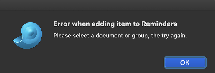

Was an item selected? I just ran it here on 10.14.6 and it wors as expected.
Yes, an item was selected.

Jumping on this thread. I’m running the latest version of 3.0 (release) and when I try and run the Reminders script I get the error message below.
I’ve tried quitting and restarting. I checked the permissions and they are all find under automation.

The issue is that DT3 needs to be on this Security menu:
The problem is that if you inadvertently answered “No” the first time it asked for permission, there is no realistic way to fix that short of re-installing the whole OS from scratch or some other similar major redeployment of the operating system.
