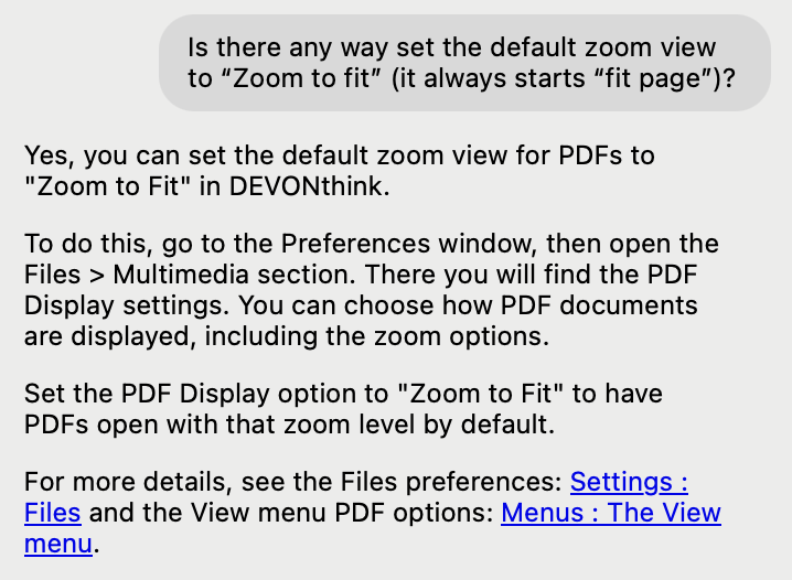

Is there any way set the default zoom view to “Zoom to fit” (it always starts “fit page”)?

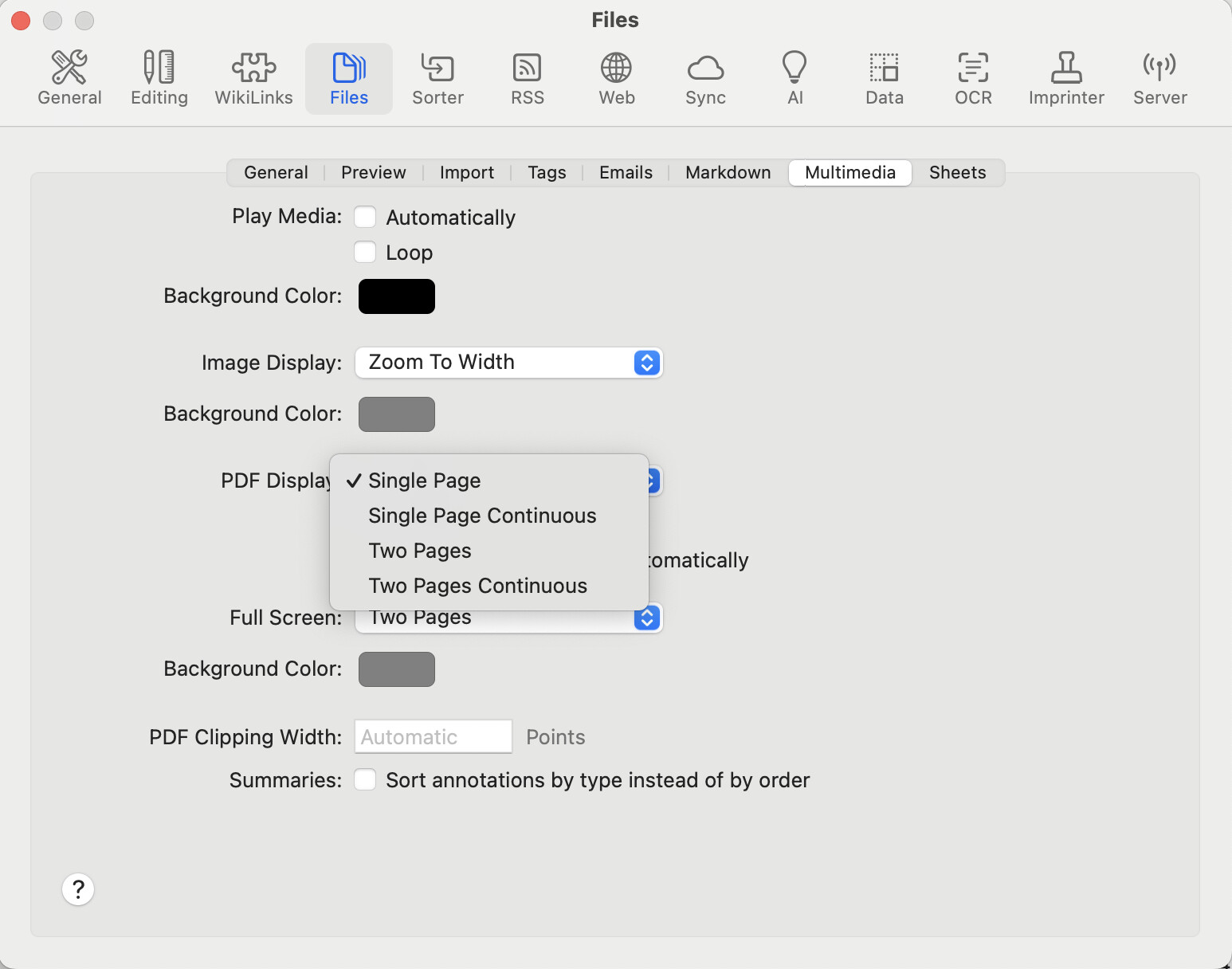

Files > Multimedia > PDF Display and choose a Non-Continuous mode.
This is in the Settings > Files chapter of the built-in Help and manual.
The help viewer’s chat of DEVONthink 4 (Pro/Server) can answer such questions too and immediately:
For this test I used OpenAI GPT 4.1 (Mini).
But there isn’t a Zoom to Fit option under the PDF Display settings. There is for the Images
thanks all!
…I did search the manual but wouldn’t have found that in a million years. I was searching for things like “default zoom”.
