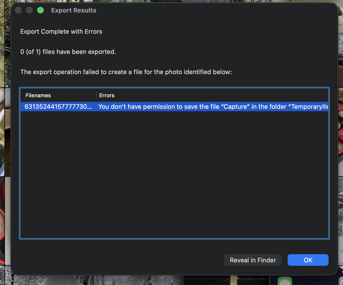

I also get, if I try to move things from Photos to DEVONthink, this
the photos move into DEVONthink anyway though but I have to dismiss that window by clicking ‘OK”.
