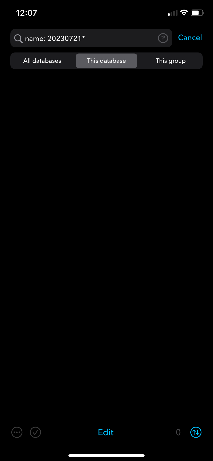

Since the latest update a Shortcut I use to retrieve a record by date/name has stopped working.
This was a problem that seemed to have been fixed a few months ago but has returned.
In my case all the record names in this database are formatted yyyymmdd hh:mm and the shortcut looks for the date in the name with an asterisk added at the end.
I just tried doing a search by date name in DTTG and it won’t retrieve the most recent record (today’s record) but it will get records from previous days.
Screenshots:

I get the same results with quotes around “20230720” and no difference using name:

In DDTG it was not finding anything after 20230720, no matter what form the search took (name:, quotes, with/without the * wildcard)
I have been travelling and hadn’t synced (or powered on) DT(3.9.2) on MBP (M2 Max, 13.4.1) since 20230717.
I powered on the MBP and did a sync this morning via Dropbox. Searching in DT works fine but DTTG(3.7.3) on XR (iOS 16.5.1) doesn’t find anything after 20230720.
Quit all apps and cold restarted the MBP. Sync - no change
Force quit DTTG on Xr - restart DTTG - Sync - no change
Force quit DTTG on Xr, shutdown Xr. - restart Xr and DTTG - Sync - search works, even with no name prefix, quotes, or wildcards.
