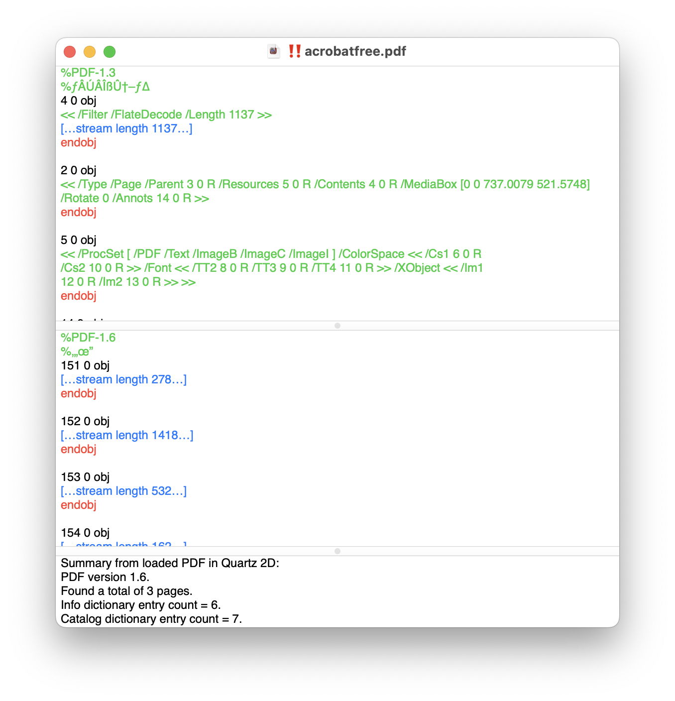

This is not prescriptive, only descriptive, e.g., not all PDFs are the same therefore you can’t reliably assume changes will triple the size. PDFs come in a dizzying array of forms from over the years, many with very aggressive compression. When a PDF is resaved, it uses the compression algorithms of the framework in use. This can lead to the compression level being less (or even more) than the original’s.
I hadn’t noticed the issue, but I’ve not been annotating that much. Just did a test and saw only a little increase in size (about 18%). Another workaround for you might be just to open the file in Preview and immediately export it with the Quartz filter option set to reduce size. Same annotated file I tested reduced by a factor of 16x. May even be a way to automate the process with a smart rule or something.
Here is a piece about how Apple’s PDF annotations work.
