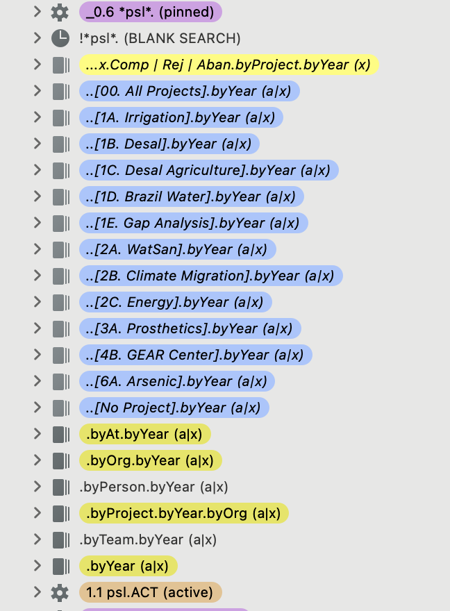

Thank you for all the thoughts and suggestions! They are much appreciated. I will have some time to look at this more in depth this weekend and consider alternatives. In the meantime, I just want to confirm that everyone (seems) to be in agreement that there is no way to use a lot (10,000s) of smart groups within DT4 that is going to viable. Is this true? If I create 10,000 smart groups, it is always going to be a drag on performance? Is there any ability to toggle behavior so that the smart group only conducts the search when the group is opened?

However, I am still trying to understand why it is slow for me to scroll up over groups that have a lot of smart groups even if the smart groups aren’t open or visible. Is there something about scrolling over a smart group that causes it to redo the search? It isn’t slow to scroll up past the highest level groups – only the groups that contain smart groups as immediate children.
So scrolling over this takes several seconds of stalling before I can scroll up in the sidebar, where each group contains 10 or so smart groups:
However, if I collapse this all under one parent group, I can scroll over it easily with no stalling. I am trying to figure out if the stalling issue is due to the smart groups or some other issue.
Thanks

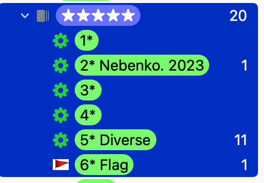

What happens if you copy a few (all) of your smart groups from the sidebar into a DT RTF document (the links, ⌘⌥⌃+c)?
Then scrolling should be no problem, and you can open the group by right-clicking and selecting “Open in DT.”
Sidebar
RTF doc
