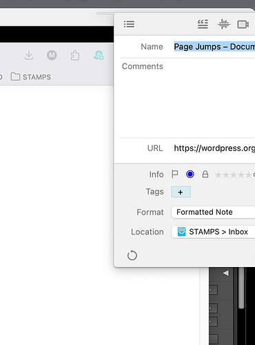

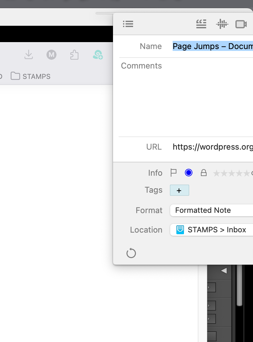

A bit annoying this one: I click the clip to DEVONthink icon, the popup is partially occluded - check the image. It would be ok if I could save using the return / enter, but it seems like the “Add” button in the popup doesn’t respond to that. Any ideas what could be causing this? tx! [latest macos, firefox, DT4-beta]

Is the screenshot supposed to show that the sorter doesn’t stay within the bounds of your screen? I don’t know anything about that.
tx Troej - yes, the sorter went out of bounds

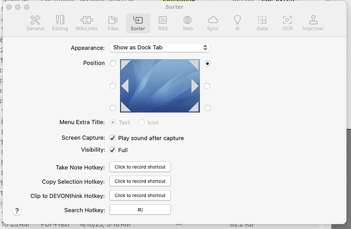

Can you post a screen capture of your Settings > Sorter?
Jim, thanks - I was able to find out a bit more. The issue happens when the appearance is “Show as Dock Tab”. It has something to do with the DT window and/or DT settings window being in one screen, and potentially firefox being in the other screen.
Not a big deal now that I realize I can easily use the “Show as Menu Extra” setting.
