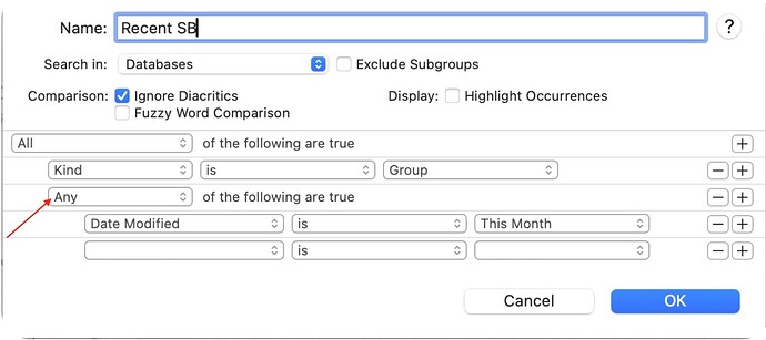

I’m being stupid this weekend. I created this global smart group in DT3 a while ago. Now I want to create a second version, again in DT3, and I can’t seem to find the “Any” operator indicated by the arrow. All I see second time round is an “All” operator and other options. Can anyone help me be a little more intelligent? (the field under “Date Modified” is blanked, because I will insert a different search term there, hopefully to show when I have merely looked within a group).
Well, what happens if you click on the “All” button?

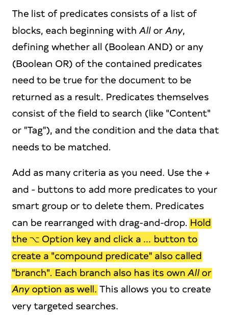

When you click the plus button, you get a new predicate. What you want is a new branch (or “compound predicate”). Hold down the option key, and the plus buttons turn into ..., which adds those. (Smart folders in Finder, Mail etc. work the same way)
See Windows > Sidebar: Smart Group and Rule Editor > Predicates in the manual/help.
Thank you so much! Yes, the option key did it!! Sorry not to have found that for myself. The various AI engines were just telling me to press the plus button.
I was getting “Any” there, but I was after a second branch, which troejgaard has very kindly helped me find with the Alt key. I must have somehow found the Alt key option before without realising it. It is there in the notes, I have to admit. I just didn’t see it. Thank you for saving this particular user from further frustration.

I see how that could be confusing. But that “Any” is not a boolean operator – it means “Any metadata”. You might perhaps infer that from its placement at the top of a long list of metadata fields, in case you forget it again :wink:
Main thing is it allows me to input an either / or!

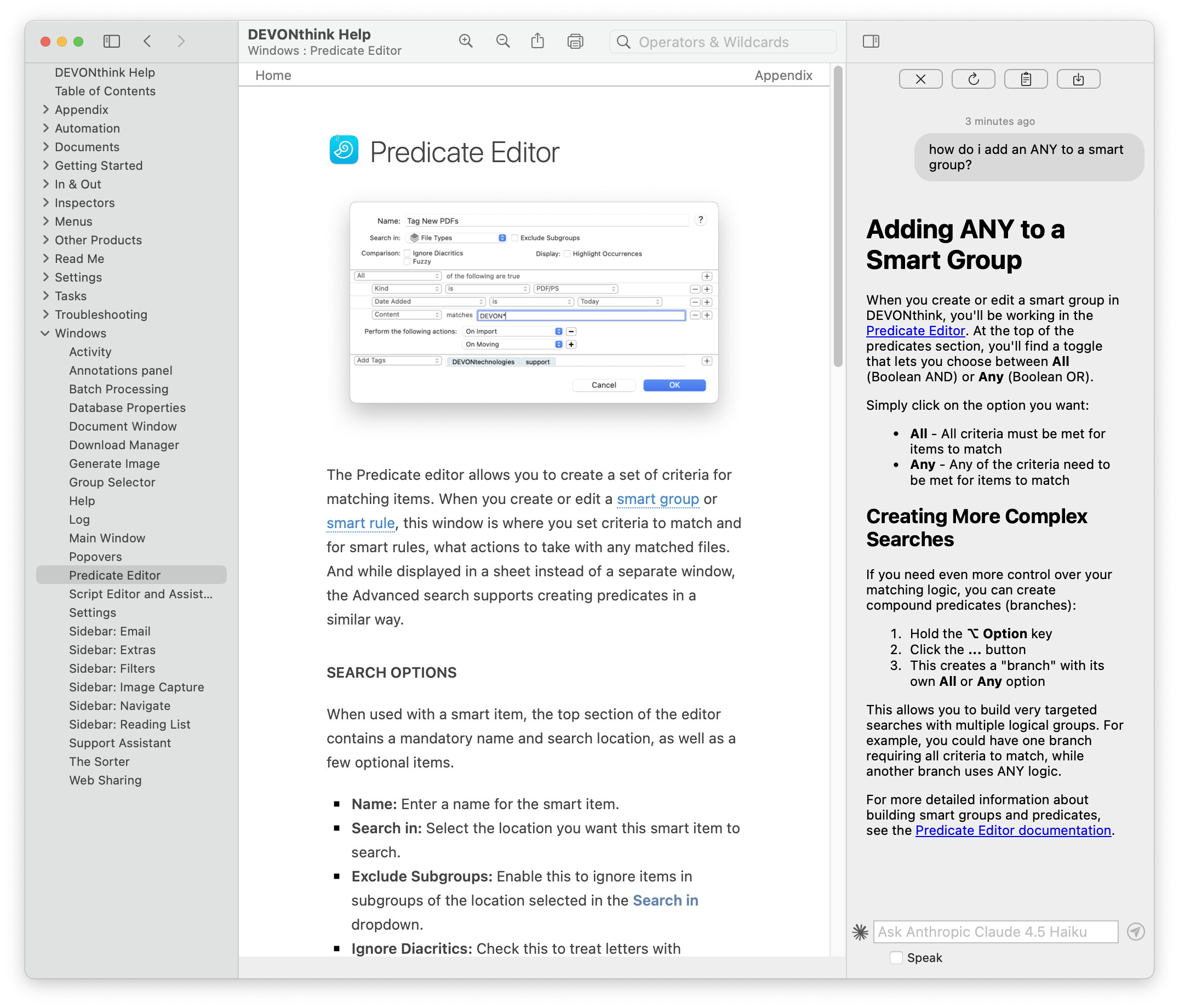

I am very curious why do you keep asking “various AI engines” DEVONthink-specific questions when they keep offering incorrect solutions?
The documentation, our Support Ticket system, and these forums are the best resources.
Also re: the documentation, DEVONthink’s Help Assistant in DEVONthink 4 gives you answers with a much higher degree of accuracy compared to chatting with ChatGTP, etc.
