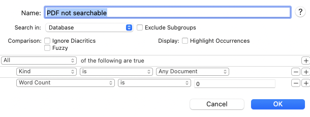

Post a screen capture of your smart group’s criteria.

This is the way it is currently (and it shows 1000+ photos in there)
Screen Shot 2022-04-13 at 5.19.04 PM
Your should check your Kind criteria (Any Document)
Thanks @DTLow I can remove images from the smart folder by creating an “is not images” rule, but it also will remove all my images that are screenshots as well that could be OCR’ed. My first guess was the tagging of photos as “photo” to solve the problem but since I’m new to tagging I just wanted to know if there is another solution. If I could make a rule to separate JPG from PNG files that could have worked but I don’t believe I’m able to do that.

You can use the Extension is criterion to filter.
Thanks for the extension criteria tip @BLUEFROG, and @DTLow, I had to do one manual review of my smart box then add the NOT JPG rule and sort by date added, that easily makes my smart box show me what I need to OCR and I may do a JPG only smart box to make sure there aren’t any JPGs that could be OCRed that I missed otherwise.
