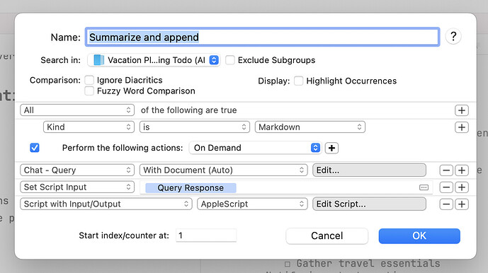

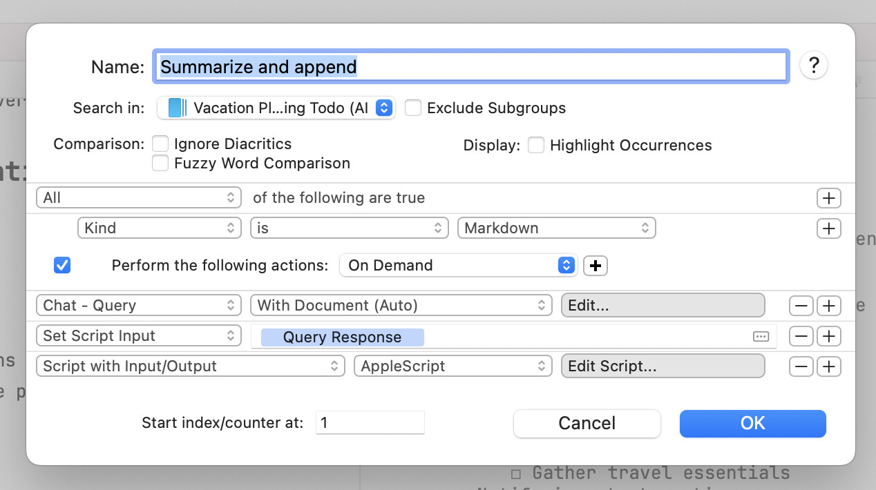

In the continuation of my Weekly Newsletter summarization idea, I would like to create a smart rule that sends a document to an LLM for summarization and then appends the result to a Markdown file.
I have created a smart rule, that sends the document to the LLM for summarization, but I can’t figure out how to take the resulting text and append it to a Markdown file.
Furthermore, when I do this, can I count on the Smart Rule to be blocking and not run in parallel? I want to make sure I don’t competing writes to the Markdown file.
You need to use a Set Script Input action using the Chat Response placeholder. This is passed to a Script with Input/Output action where theInput is used with an update record theRecord with text theInput mode appending command.

on scriptOutput(theRecord, theInput)
		update record theRecord with text (linefeed & linefeed & "---" & linefeed & theInput as string) mode appending
end scriptOutput

Darn I forgot to ask a supplementary question. In your example, it appears that the smart rule is appending to a Markdown file it found in the rule itself (theRecord). In my case, the document it finds is the thing being summarized. So how do I tell the AppleScript to append to append to a common Markdown file. For example: NewsletterSummaries.md?
Locating a document is commonly done via its UUID.
set commonDoc to get record with uuid "x-devonthink-item://9D336907-90A9-48B8-BFEE-1374424F9AE1" -- Logically, with the item link of your actual document
update record commonDoc…

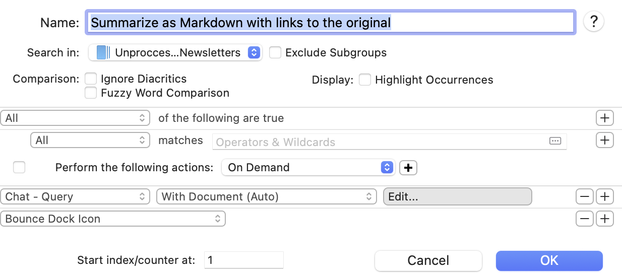

There is a still a lingering issue. With approx 1/5 → 1/10 of my documents, it fails to generate a summary. I’m guessing the model times out. Could I set this up with a retry mechanism? (ideally that would be built into as an option).
For summarization like this the speed isn’t critical, it’s a background process. I care more about it being reliable.
As an illustration in 41 documents, 14 failed to generate a summary. When I try to run it again, some will still fail.

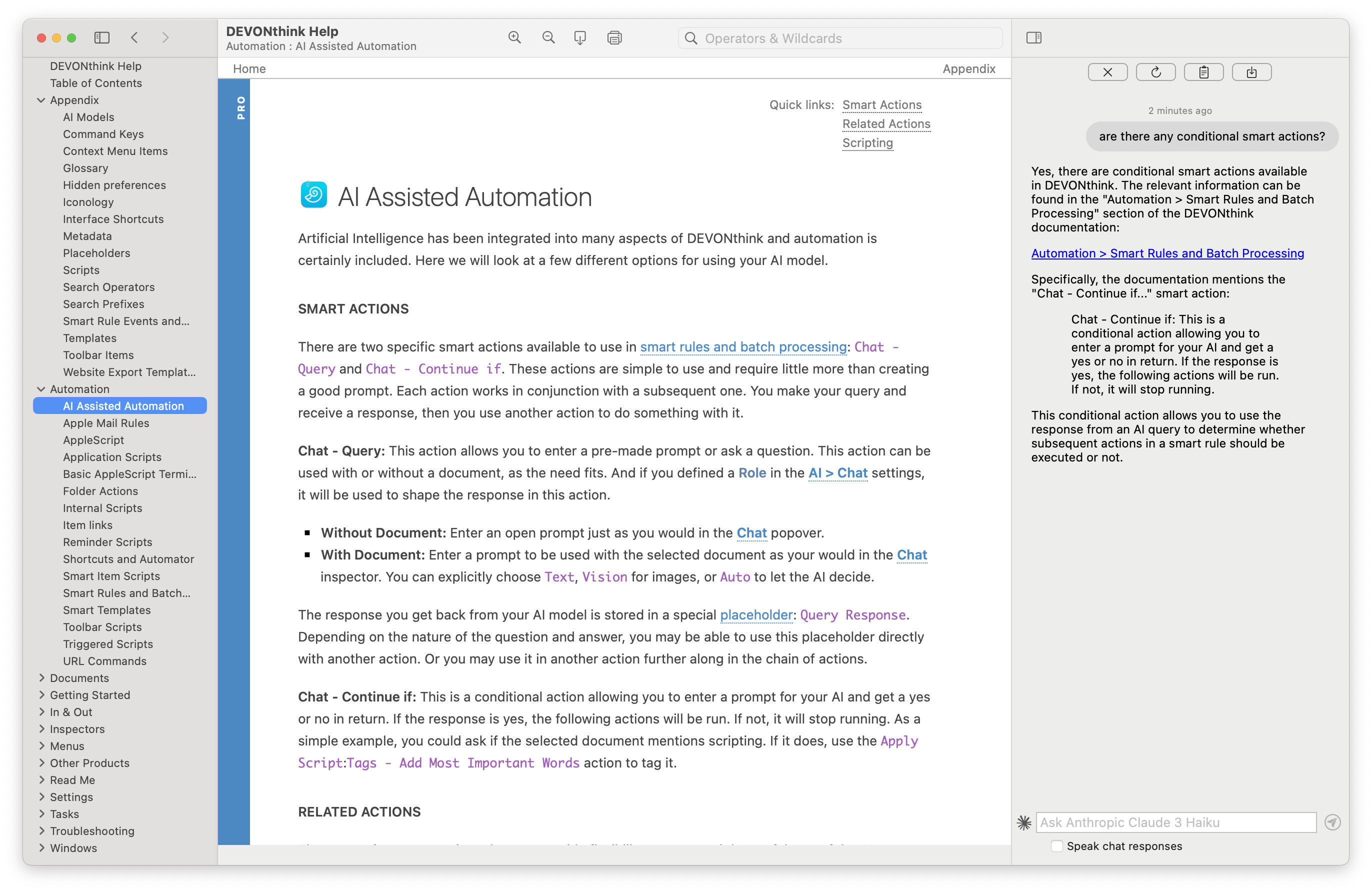

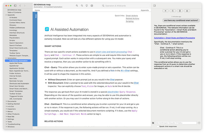

I don’t see anything that looks like a conditional in the Actions section of the Smart Rule. Please help me see what I’m missing.
There is only one conditional action: Chat - Continue if. This is noted in the Automation > AI Assisted Automation section of the built-in Help and manual
