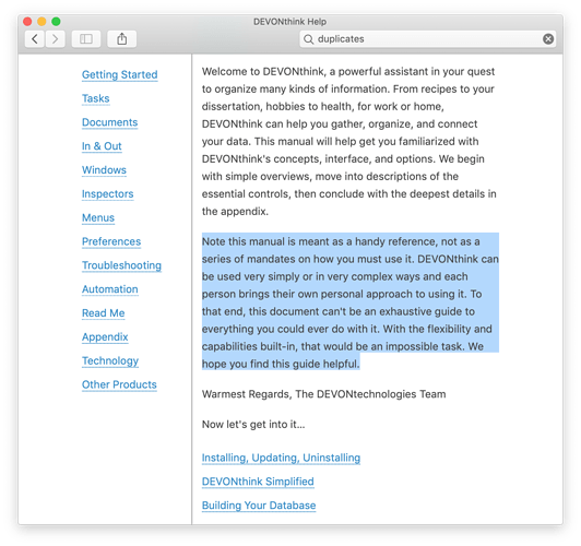

Help > Documentation > Getting Started > DEVONthink Simplified.
There is info on Smart Rules in Automation > Smart Rules, but remember they have different purposes. I don’t suggest creating smart rules if smart groups are needed.
