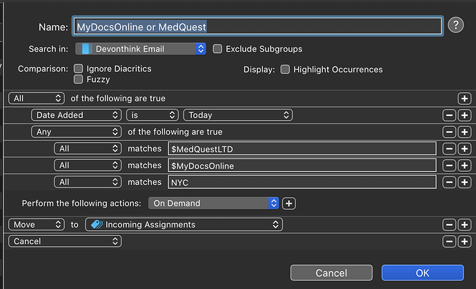

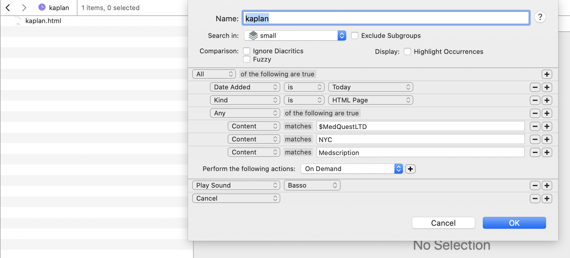

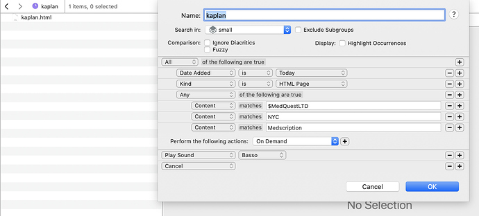

Consider this Smart Rule:

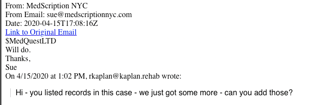

And consider this document as an HTML text file:
The rule does find these if I adjust the search terms in the rule with the same format among the “Any” section:
Sue
thanks
records
The rule does not find these if included as search terms:
NYC
$MedQuestLTD
MedScription
What is the pattern for what it will match and what it will not match on?
I am not seeing an issue with this.
I’m curious why are you matching on All if you’re looking for content matches?
I am matching on “All” because sometimes the text I am looking for may be in the Name and at other times in the body of the message so this covers everything. Does “Content” include the Name of the document?
Interestingly I see that my original configuration does work on some messages I sent after I did this post. Is it possible that there is a delay to index a new document and thus I was testing the rule earlier before the indexing was complete? The terms that previously worked were at the end of the alphabet - does the indexing perhaps go from Z to A and span all documents rather than complete an entire document A-Z at one time? And perhaps “Content” instead of “All” would be quicker to index?

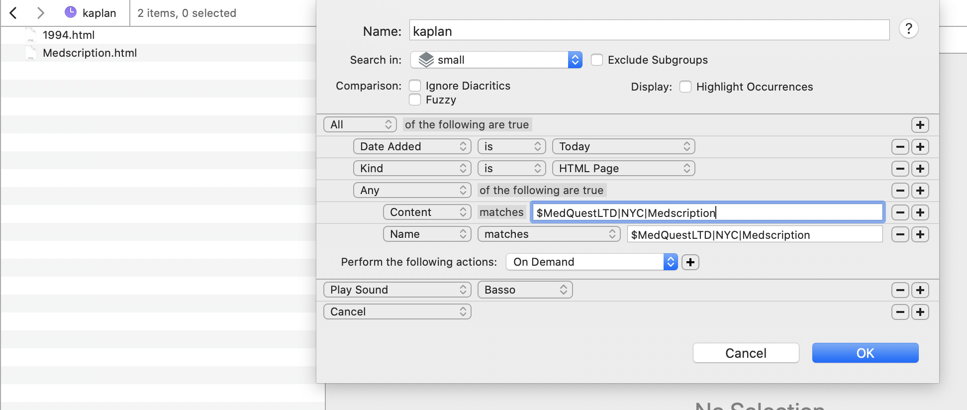

No Content doesn’t include the name.
You could use a structure like this…

I believe I have identified the cause of the problem.
Can you try unzipping this file and then referencing the .html file in a Smart Rule with a Content search for
$MedQuestLTD
The search will fail
Then convert the file into .rtf or .pdf and the search will work
Then go back to the .html file and move the word $MedQuestLTD further down the file into the <html> section. Then too it will work.
So it appears that the search for Content in a smart rule does not include the headers in an .html file even when those headers are displayed and look/act like content in other respects. Is that the desired effect? Or would you consider changing your code to search the entire .html file for content?

News Alert Trump threatens to invoke never-used constitutional authority to adjourn Congress and push nominees through.html.zip (4.6 KB)
Actually this is not a valid HTML document, only the HTML body is indexed. How did you create this file?
