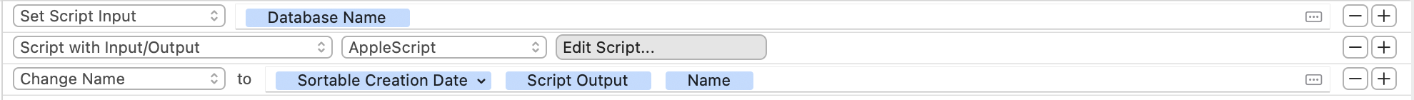

Hello,
I hope I can explain it in a way that’s understandable.
The plan is to improve the naming of my Markdown files for better linking. But I still want it to be a bit Human Readable.
An example would be YYYY-MM-DD-SHORT name.md
With the following I struggle:
  • SHORT: That should be based on the database, but not the exact database name.
Example:
I have the database “Projects 2025” and the SHORT should be PJ25 or even just PJ since the date is in the name anyway.
But where can I define that in a way to access it again in the rule to change the name?
I can’t use the custom data types since I want to archive when I move the file from the Inbox, or create the file outside the Inbox.
Which means
  • The rule should apply in two cases.
    • When the document is moved away from the inbox to the DB (simple)
    • When a markdown is created anywhere other than the Inbox
I would love to filter that somehow, since I guess the alternative would be a rule for every Database?
So in short, my two Problems:
  1. Placehold Based on Database Name for File Rename
  2. Rule running when moving from Inbox or only when creating the file outside of Inbox.
I currently use Devonthink 4.1
Thanks for any help,
Bastian

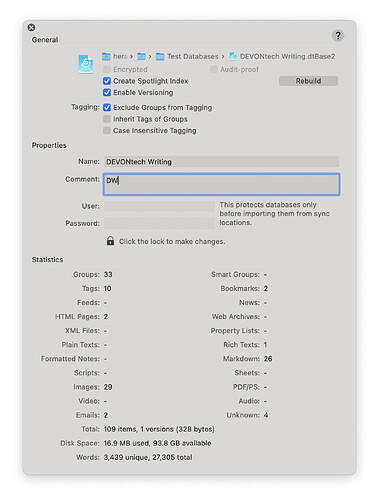

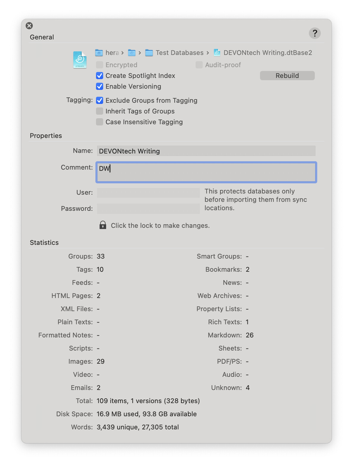

In File > Database Properties, you can set the Comment field to any arbitrary value.

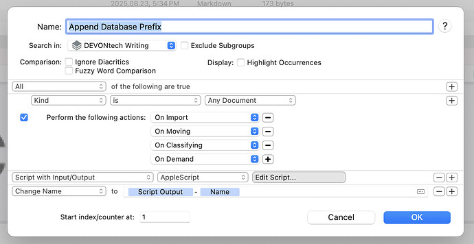

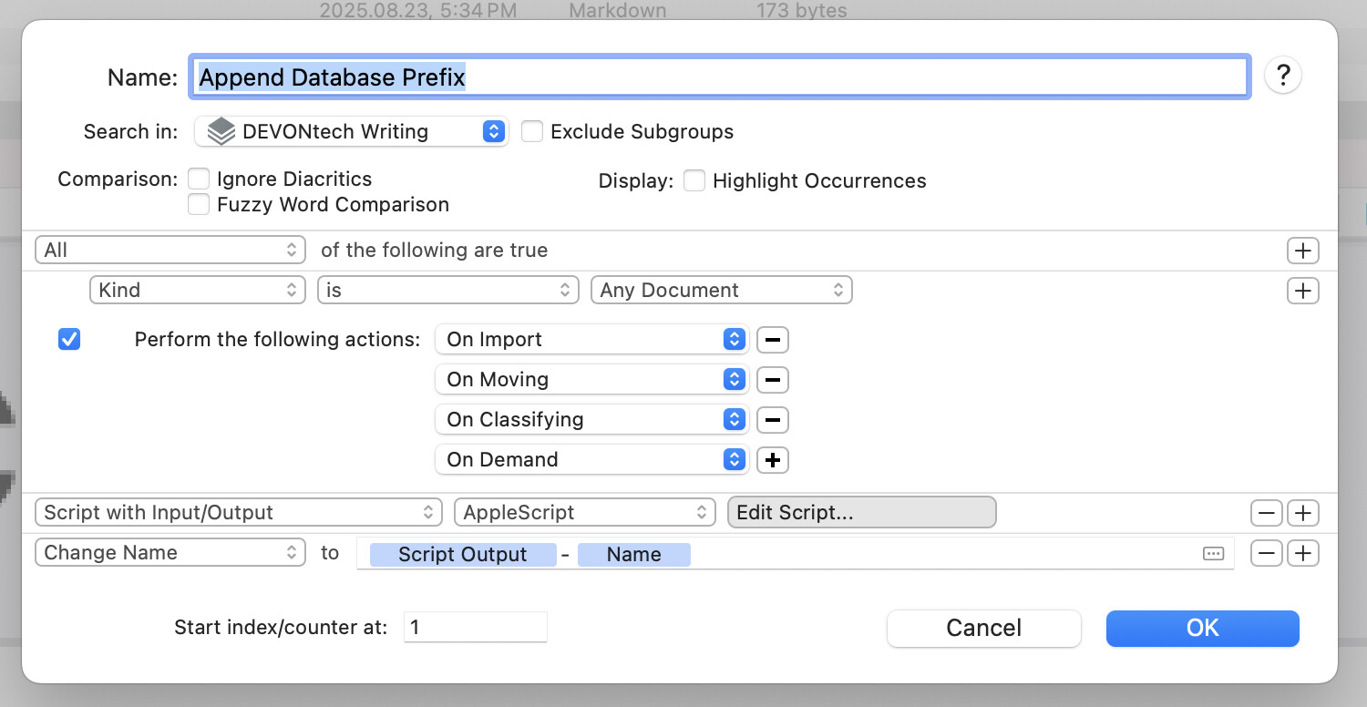

An example smart rule…
And the script…
on scriptOutput(theRecord, theInput)
		return comment of (database of theRecord)
end scriptOutput
Wow, thank you; that works perfectly and is precisely what I was looking for.

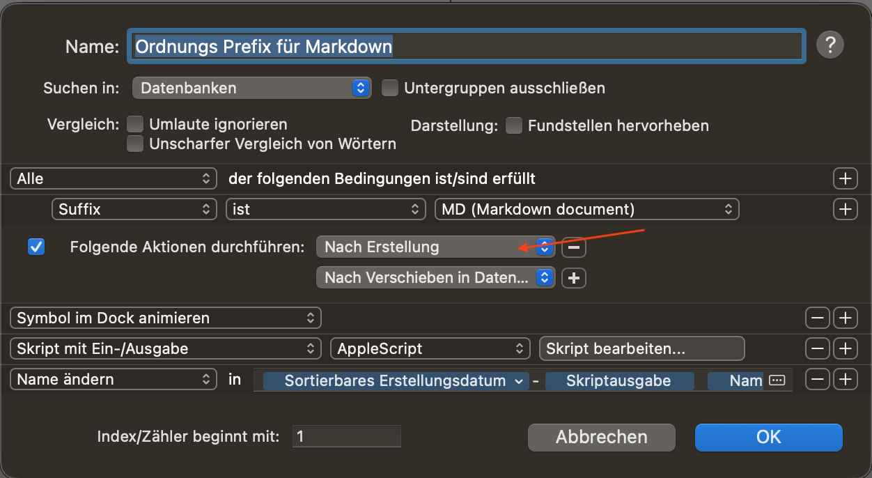

But what about the creation? I want this to run in any database, but not the Inbox. So only when I move the document from there (or somewhere else) the rule should start.
Then you must attach it to the database you want to use it with: Replace Suchen in Datenbanken with Suchen in <name of database>. There’s no Search everywhere _but_ operator.

Again, rules aren’t triggered when moving things out of a database. They only get triggered when receiving something, either by creation, moving, importing, classifying, etc.
