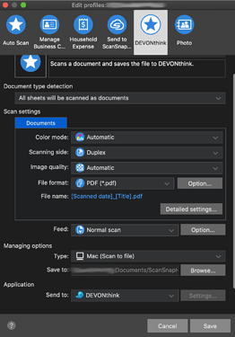

How have you set up your scanner? Again, just wondering whether your scans are arriving in DT differently that mine are. My scan profile is as so (the important bit must be the managing options and the application, at the bottom).
Thank you for pursuing this so diligently. The scan profile looks exactly the same except for a different in file name format. So strange.

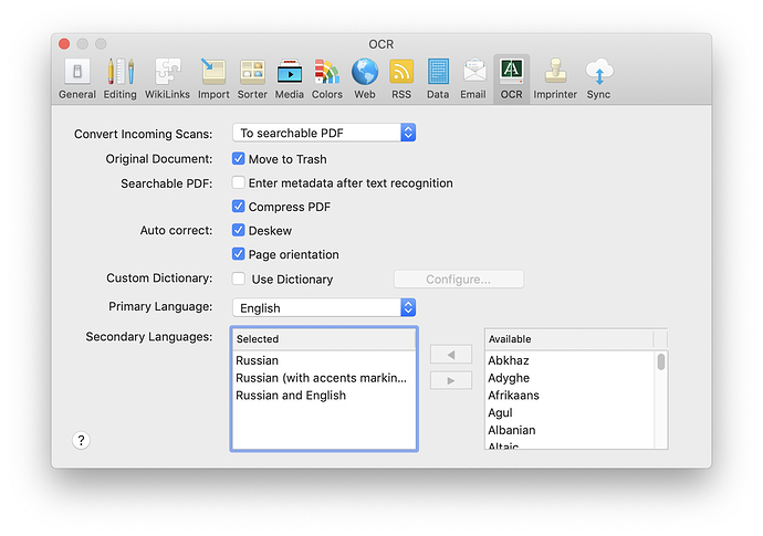

A screenshot of Preferences > OCR might be useful too. In addition, which version do you use?
But actually it’s an import event in this case (performing OCR or not depending on the preferences), therefore the triggers on scan or on import should work.
Version 3.0.4
This looks fine. Did you notice my second reply?
