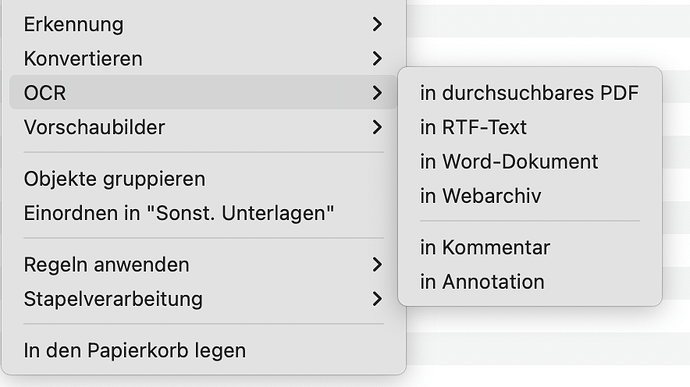

If I - on the other hand - execute an OCR manually via the context menu the PDF-document gets deleted after the OCR process as expected.
