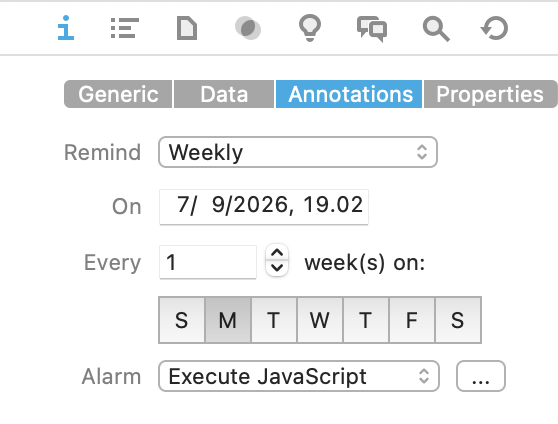

You can set up everything in the smart rule itself (scope, actions) and use a simple reminder script that is just a trigger.
Create whatever document; you just need something to add a reminder to. Maybe a text file explaining the purpose of the smart rule plus an item link to it. Open Inspectors > Info > Annotations & Reminders. Add a weekly reminder and select the alarm Execute JavaScript/AppleScript.
Click the ... button to edit the script. Here is a simple JavaScript. Just add the name of your smart rule:

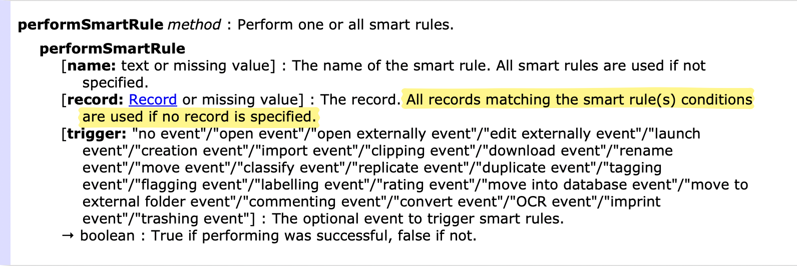

For a little more detail, here is performSmartRule in the scripting dictionary:
