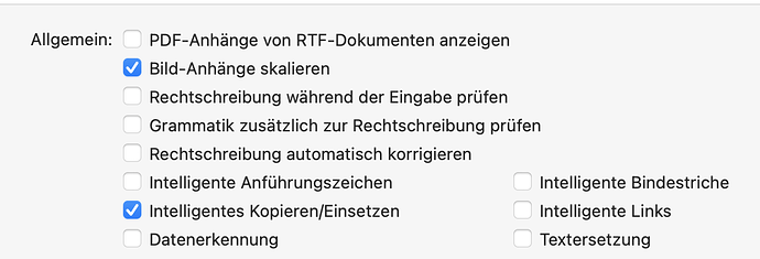

But I think that you can simply turn on intelligent quotes in DT’s global settings:
That of course only helps with MD that you write in DT. If you import it from somewhere else, the quotes will probably remain what they are.

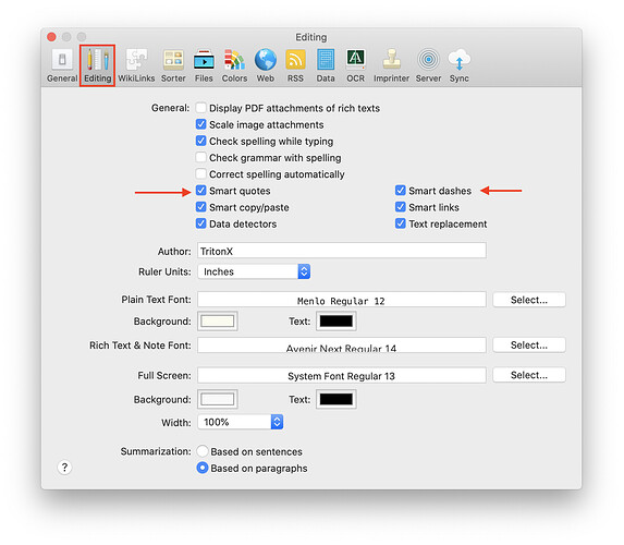

This will not convert existing quotes and dashes. It is a replacement technology that will make the change on-the-fly as you type.
If you don’t want this to be a global setting, you can also enable this on a per-document basis via the Edit > Substitutions commands. However, you should enable it before you start editing. The commands are also available in the contextual menu.
