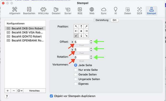

I found that the way the preferences on the stamp position/rotation are set is not consistent: when i type the position in the number field (red), it will not be saved when leaving the preferences and coming back. to make the change be persistent, I have to klick the arrow buttons (green) to dial the position.
(DT 4.2 on macOS 15.7.4 (24G517))
Thanks for the report!
I am only seeing an issue with the Rotation field, if I do this:
Type number → Tab → Type number → Tag → Type number → Close settings without a Tab before closing.
I couldn’t reproduce this, for me all the settings were saved. I have added some additional checks to ensure that these settings are saved.
