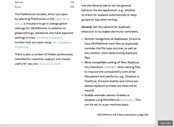

See also DT > Preferences > General More compatible naming of files. That is described like this in the the user guide (also available through the in-app Help):
Stephen
Thanks Stephen, I had this checked, and as chrillek advised me – thanks! – I would prefer to leave the question mark in this case as well and stick with the compatible versions.
But still: the double underscore at the beginning of a file name should work as far as I checked the forum and documentation. So if this would basically work and keep file names in the Finder and document names in Devonthink consistent, that would be great.
