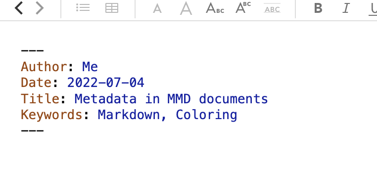

That’s what Hugo does with its frontmatter:
author: me
date: 2022-07-04
summary: No idea
Makes things clear, of course. And should in fact also work with DT’s MultiMarkdown:
The metadata must begin at the very top of the document - no blank lines can precede it. There can optionally be a --- on the line before and after the metadata. The line after the metadata can also be .... This is to provide better compatibility with YAML, though MultiMarkdown doesn’t support all YAML metadata.
(taken from the documentation of MMD 4, we’re at version 6 now).
And apparently, it works in DT, too. Your wish has already come true.
The next release will improve the recognition of metadata headers in the editor.
