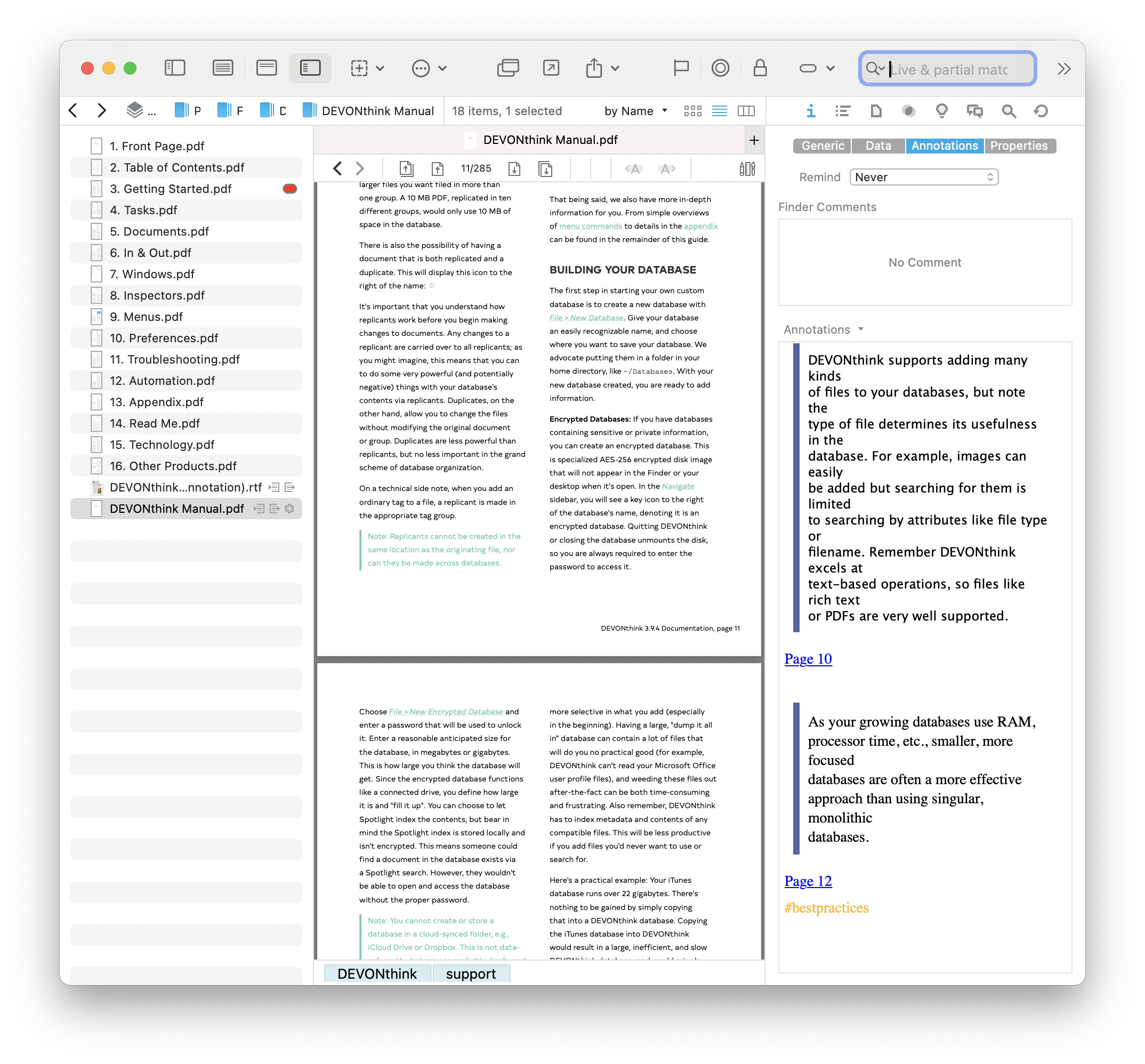

Personally, I would start with an annotation file and take notes on the PDF. You can click the popup menu and use Insert Quote to add selected text to comment on.

Jim, which “pop up” menu are you referring to…? I can’t seem to find it (and same for the “insert quote”). Could you please point me to it?
p.s. I’ve tried your other approach (“paste with the source link”) and it does help, thanks! I’ve created a new note, and just pasting with the source from the pdfs I’m reading.
Here’s what I found:
  • Select text in the pdf file in dt.
  • Click “annotations” in the inspector.
  • A pop-up menu appears with “insert quote” as an option.
  • Click “insert quote” to create a new quote with the selected text and a source link.
  • A new “collection”(?) is created in the same database as the PDF, containing a new annotation file with all quotes for that pdf.

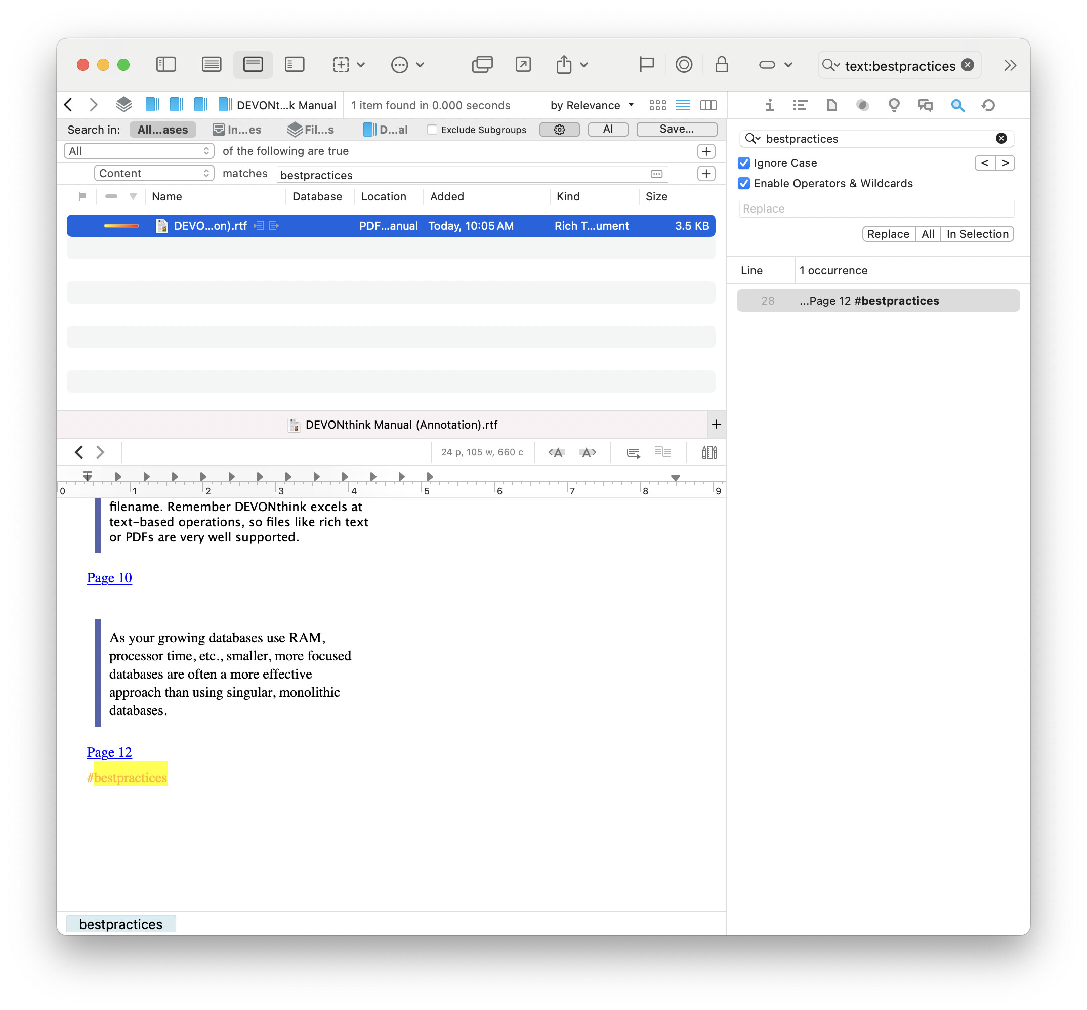

Jim, in this example: #bestpractices tag is not “interactive”? that is, it’s not clickable, correct? it only helps with searching, right?
Correct. Hashtags are just words, not links.
However, if the command or setting to convert hashtags to tags is enabled, the document will have it as a tag. You will then be able to search for it as a tag.
