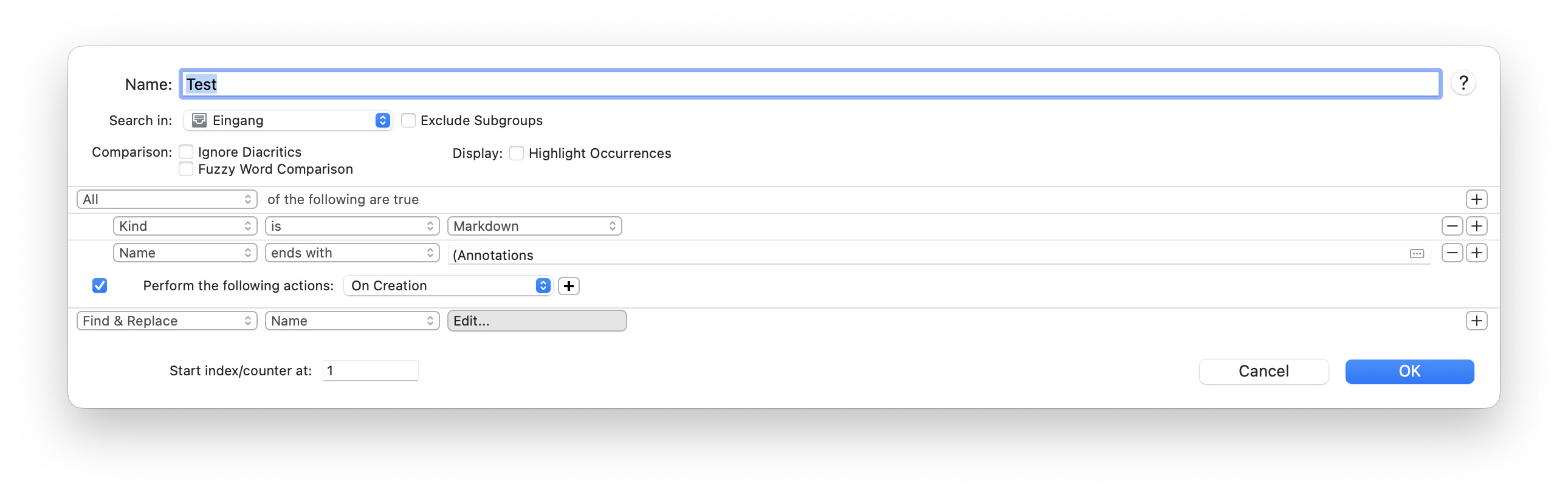

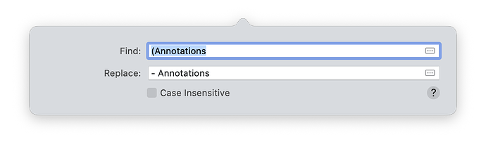

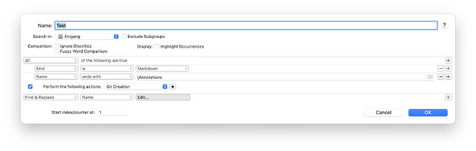

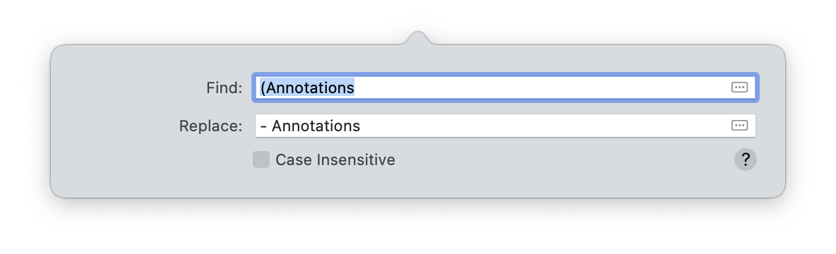

You could use a smart rule triggered on creation that uses the new Find & Replace action:
P.S: The name should actually end with (Annotations), the next release will fix this typo.
