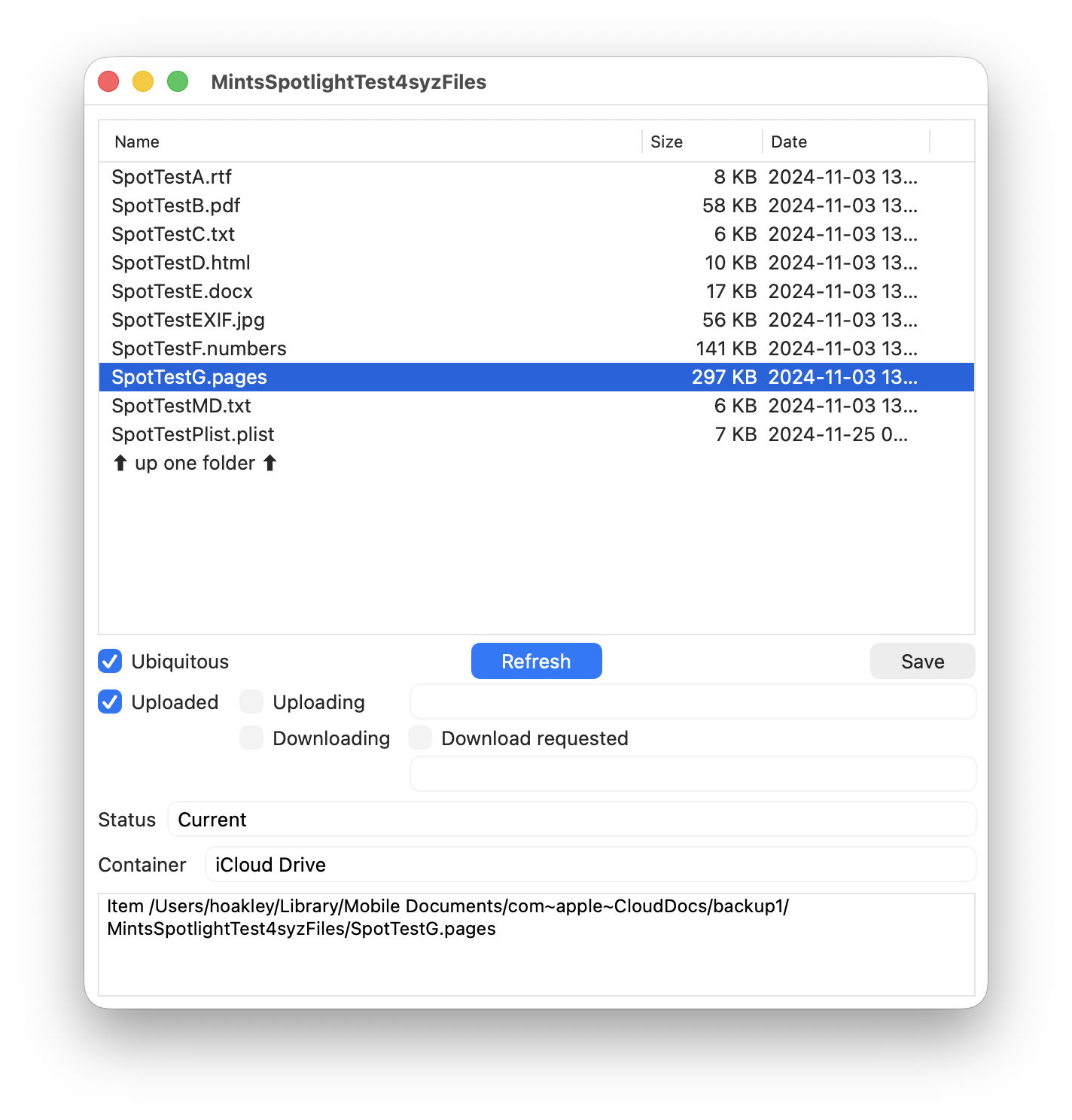

When it comes to problems with iCloud I would always look to see what Howard Oakley has to say about it:
It is worth downloading his Cirrus app for troubleshooting.

In the past I have experienced downloads getting “stuck” and have successfully used Howard Oakley’s freeware Cirrus to “unstick” them. It might be worth a try:

I’ll check on Cirrus, though, as something to keep in my toolbox.
