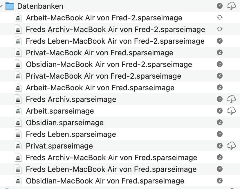

Hi, I use 2 Macs and want to use my DB on both of them, not at the same time but in sync. I thought it would be a good idea to do it with Onedrive but did run in trouble. The second mac synchronized his own version. What did i wrong. Thanks for any help. Fred
You do not want to put a Devonthink database in a cloud synced folder. Really bad things can happen.
If you want to sync your database with 2 Macs the best way is to set up a sync store on a NAS drive and then sync each Mac to that sync store.

  1. @rkaplan is correct. You should never put a DEVONthink database in any cloud-synced location. This is well-known and documented.
  2. Did you manually create all these .sparseimage files?
  3. If not, are you always using encrypted databases in DEVONthink and why?
  4. What version of macOS and DEVONthink are you running?

At a glance, it looks like you created a bunch of encrypted databases. Then you copied them to OneDrive while they were still open, hence they’re .sparseimages instead of .dtSparse files.
  1. The “better way” to have the dbs on two Macs is just that–have them on both Macs, not in OneDrive. If indeed you have them in OD, the first thing to do to unravel this mess is to remove them.
  2. If they were “created in the encryption process,” you must have started that process. Seems overkill to me to have that many encrypted dbs, but YMMV.
