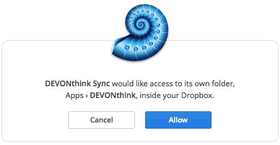

Hi, Today I cannot sync my 3 databases with DropBox as I have many times before. I get the following when DT is trying to fetch the remote store. (See attachment)
I click “Allow” but it repeatedly keeps throws up another (same) message in Safari. I’m logged into DropBox, have plenty of room, and have no other problems with DropBox that I know of. It is an API Request Authorization. I’ve restarted my Mac. I’ve even deleted the synched files and tried to start over, but getting the same problem. Stumped. Any ideas?

keeps repeating to ask me to confirm dropbox access, if I say yes, throws up an identical safari window again
There is something going on on Dropbox’s side of things.
I have just started to get this prompt for API Authorisation too, for each database that I’m trying to sync. Is there any more information that DEVONThink can give us? It means that sync can only be done manually now.

We’re getting a number of support tickets this morning for this issue. Nothing in the Dropbox code in Sync has changed in well over a year at this point, so it seems to be on Dropbox’s side. This is not the first time that it has happened and Dropbox seems to resolve it eventually.
