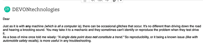

This seems to be a problem that is reported more often these days. And they I experienced myself.
The personal answer I got contained some pretty wise words that I was unable to extract all their wisdom from, my bad…
This sounds like an excuse to me. This has happened multiple times to me, multiple times to my wife, across multiple versions and computers over more than two years. I have spent probably close to 40 hours resolving the issue.
I’ve been building software and leading software teams for almost 30 years. I would never accept this reasoning from my team.
