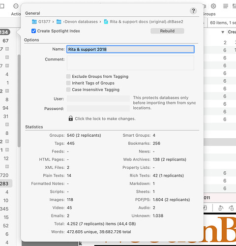

A screenshot of File > Database Properties might be useful, thanks.
Here it is.
Glen

According to your screenshots…
  1. Groups are not excluded from tagging per see (see Database Properties)
  2. But some of the duplicate groups are marked as tags, some as groups in the sidebar. Meaning that the ones having the icon of a group have to be excluded from tagging (see Info inspector)
Is this correct?

The option to exclude groups from tagging is disabled in the database properties, meaning that every group should be a tag by default, e.g.
Bildschirmfoto 2021-02-11 um 15.08.38
But some of your groups seem to be invidually excluded from tagging (see option “Exclude from tagging” in Info inspector/panel) and therefore have this icon:
Bildschirmfoto 2021-02-11 um 15.09.22
Now the remaining question is what or who created these inconsistent settings and duplicate items?

And you might also want to enable the option “Exclude groups from tagging” of the database properties again.
