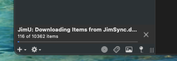

A screenshot of this message would be useful. In addition, is a verification of the sync store successful (see contextual menu in Settings > Sync)?
Hello,
Verification was successful. Here’s a screenshot of the message.

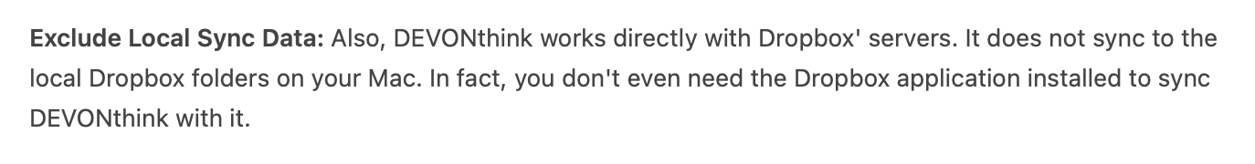

However, did you read the In & Out > Sync: Dropbox section of the built-in Help and manual? If not, do so now.

OK, I have unchecked the sync box. However, it’s still doing the downloading items about every 10 minutes or so and when that screenshot I showed above is visible, then it appears that a bunch of files are being created. I don’t really use the dropbox app much. Although I didn’t even realize it was active, would it be better to just turn that off? And, it shows a progressive number as it downloads, stops at 10361 items (doesn’t seem to show 10362 of 10362 items) then disappears. About 5 minutes or so later, it starts the whole process again.

You’re welcome :slight_smile:
The Dropbox application isn’t needed for DEVONthink to sync. I thought I covered that in the Help… indeed I did…
I think you’re misinterpreting what disabling the Dropbox app sync setting and the Activity pane is showing you. I’d hazard a guess Dropbox is stalled.
