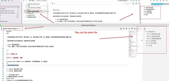

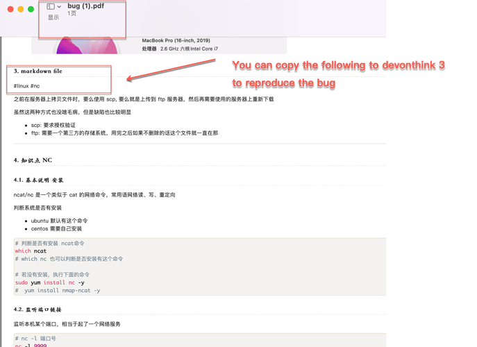

Tried to restart the software and reboot the system, but did not solve the problem
Those don’t appear to be the same file.
Please clarify this. Thanks.
Which problem, exactly? To me, it seems that the VS Code provide is incorrect since it includes the hash marks.
I’m not seeing 1 and 1.1 in the image of the TOC created by DT (disclaimer: as per my usual I have not downloaded or viewed the file attached to the post).
No worries – it’s only a PDF of the images. Not helpful, whereas the source of the MD might be.

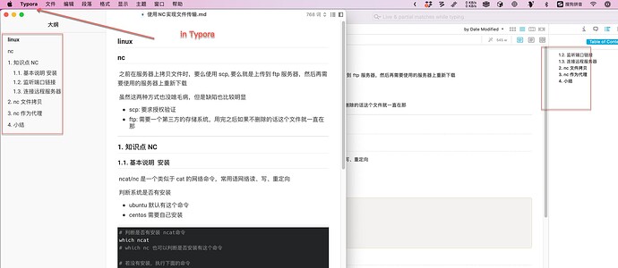

The problem is you have a preceding space in front of your headers.
You need to remove that prefixing space and you’d get a proper table of contents…
