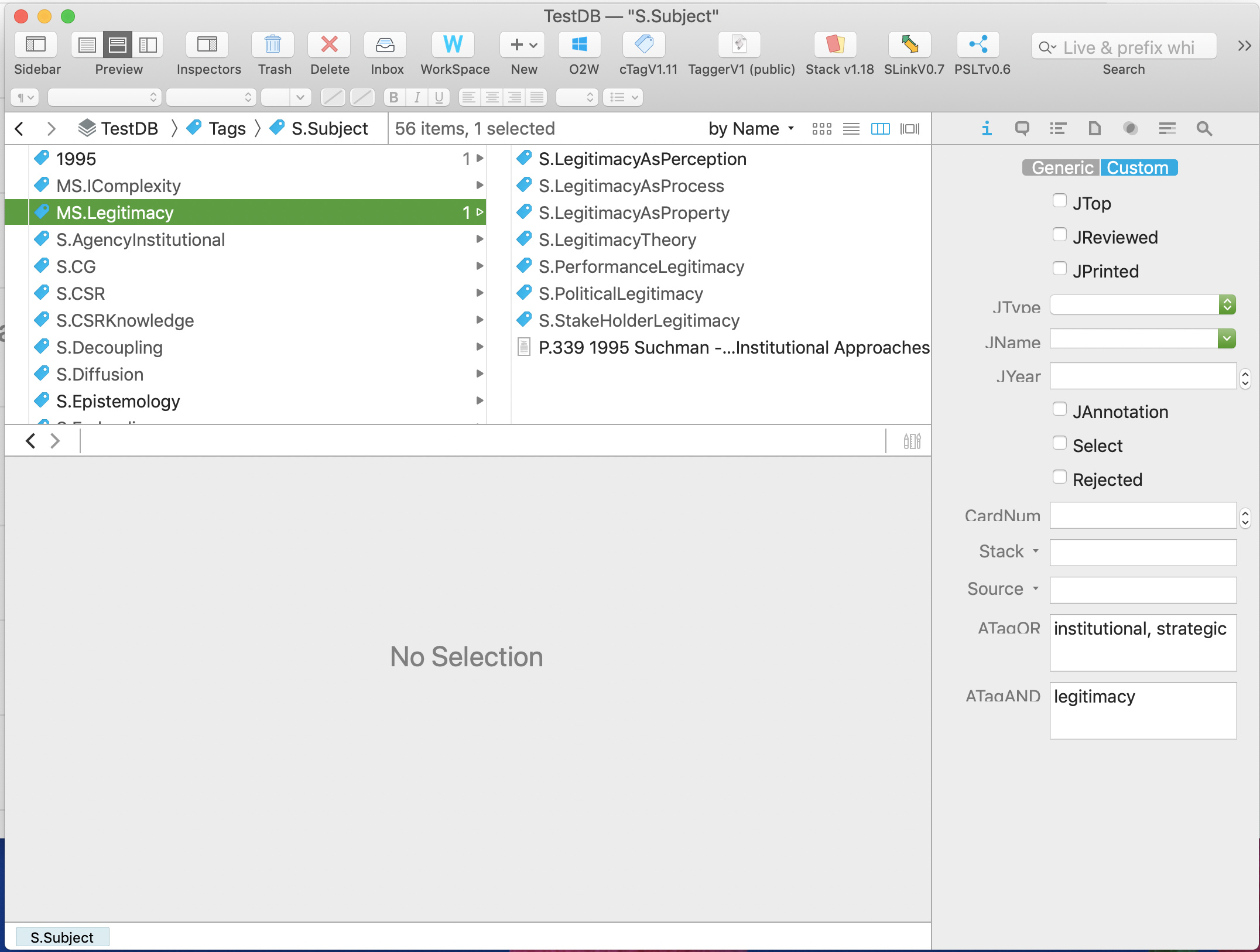

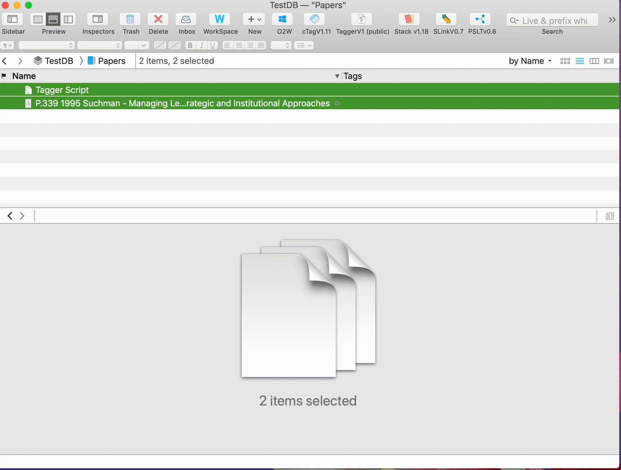

DEMO 1: Semi-automatic tagging. The script suggests tags by auto-matching the concordance AND the name of the document to each tag’s name, aliases, and the keywords in its custom metadata field “mdtagor” and the match is conditional to the existence of keywords in “mdtagand”. As far as I understand, concordance doesn’t include the name of the item, but this script does.
DEMO 2: Automatic tagging. The “documents” are auto-tagged based on the same matching mechanism described in DEMO 1.

You need to setup two custom meta data fields:
(a) You input the OR matching words in “tagor”, and those for the AND conditional match in “tagand”. Each single word must be separated by comma, no phrase is accepted. and (b) Word cannot contain symbols (e.g. “c.context” or s.test" won’t work). This auto-tagging mechanism is limited by the property of DT’s concordance. Finally, Tags SHOULD NOT be excluded from tagging. Otherwise, new and identical tags might be created.
