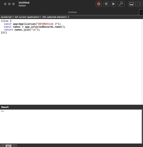

Thanks again for the suggestion - when I try this either in KM or in Text Expander, in each case the output is blank. Am I missing something?
The output is blank because there is none. All the script does is save the names (one on each line) to the system clipboard, as you can see at the very bottom of the screenshot. So Cmd-V should insert it into whereever you want to insert it.

Puzzlingly - the script takes a few seconds to execute (suggesting it is functioning) but the result is to set my system clipboard to blank. So it is working but yields no output. Odd.
Edited later… in Textexpander I get this error:
(script evaluation timed out)
So it appears that the script is failing due to a timeout error. Thoughts on why that might be?

I selected just one record - and also tried it with a few records. Same result
In script editor it does not time out - but again nothing shows up in the clipboard.
Weird. It looks as if the records had no names (impossible?) or there where no records selected. Here’s what I get:

Could you perhaps try this:
const names = app.selectedRecords.name();
var result="";
console.log(names);
names.forEach(n => result += n + "\n");
return result;
This should give you the names of the records one by one and finally the list separated by a newline. Please klick on the right most button on the bottom (the one with the three lines) and then on “Messages” to see console output.

With the console.log and other items added, the output is again blank (including selecting console output as you suggest)
And just to verify I am looking in the right place - console logs do work if I add a fixed string - but still the script overall has no output

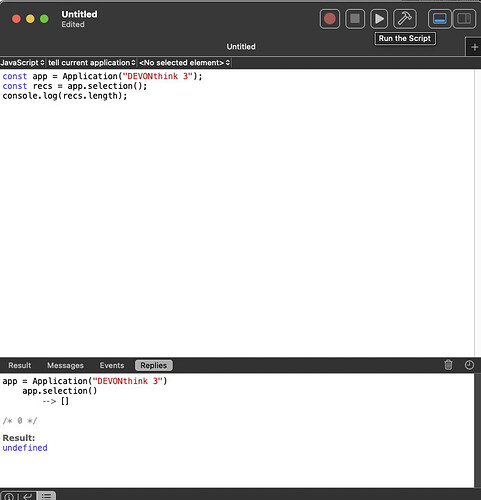

If I try these records:
The result is “undefined” as below
But the Applescript version of the script runs fine:
So is this group a RSS feed that somehow gets converted into markdown? I checked with my RSS feeds (which are all HTML) and had no problem there. But I’m really at the end of my wits here. The code is obviously not wrong (i.e. it throws no error) but it somehow fails to retrieve the selected records… You could try to use the old method like so:
const recs = app.selection();
console.log(recs.length);
And please select “Replies” in the lower tool bar, that is a bit more verbose.
Nope. JavaScript and AppleScript go through the same backend, AFAIK. And a permission problem would probably raise an error.
Yes, it is an RSS feed that is converted to Markdown. I used that as an example here because there is no personal information in that Group. But I also tried it on a different Group with just PDF files and the same thing happened.
Same response with the alternate script - if I understand the message, it means that it is not recognizing my selection
