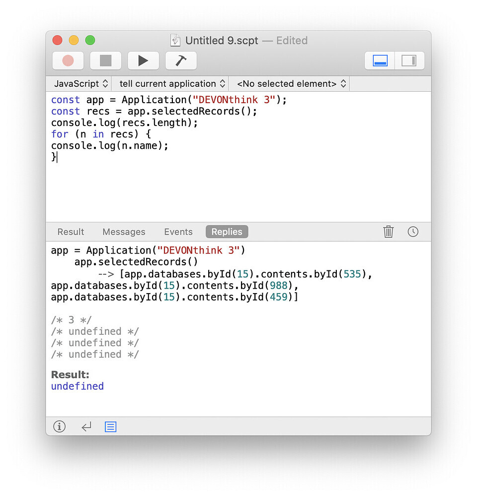

Do you have any guess what is different about my installation that could cause mine to not work where others do? Anything different I could try?
Might multiple open databases be an issue? The size of the database? What else?

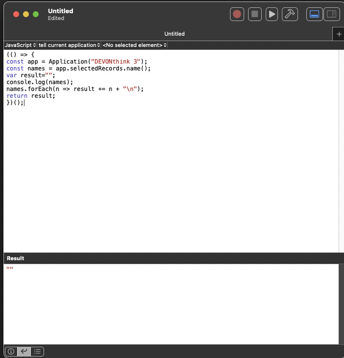

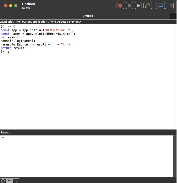

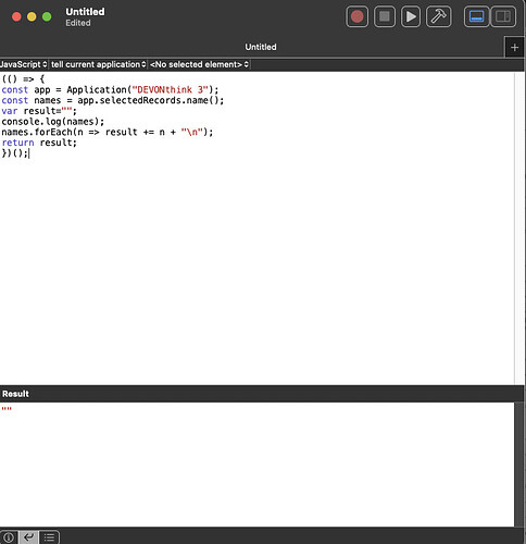

Itâs working fine over here too:
const names = app.selectedRecords.name();
var result="";
console.log(names);
names.forEach(n => result += n + "\n");
return result;
Output:
app = Application("DEVONthink 3")
--> ["Markdown Test"]
/* Markdown Test */
Ergebnis:
"Markdown Test\n"

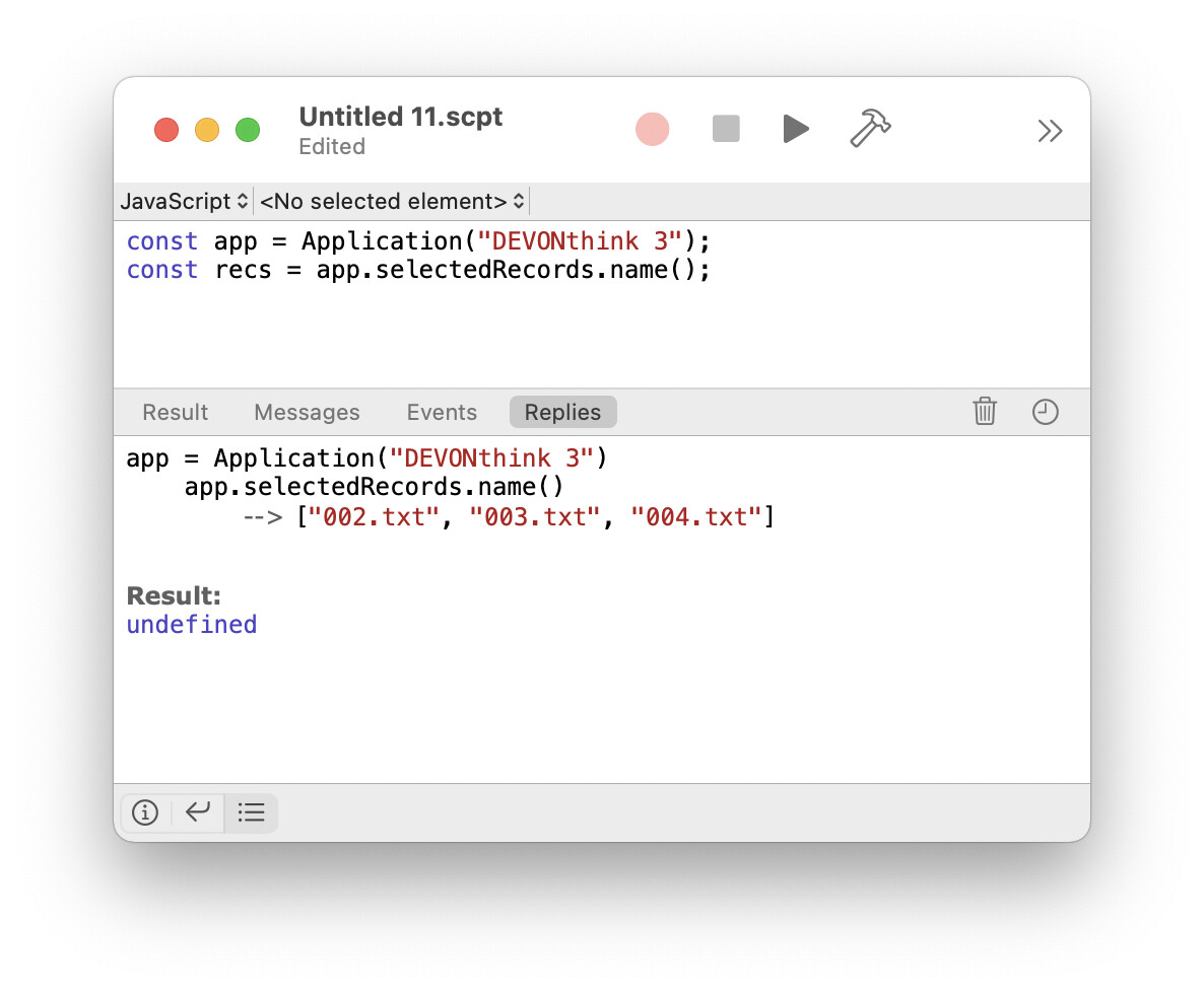

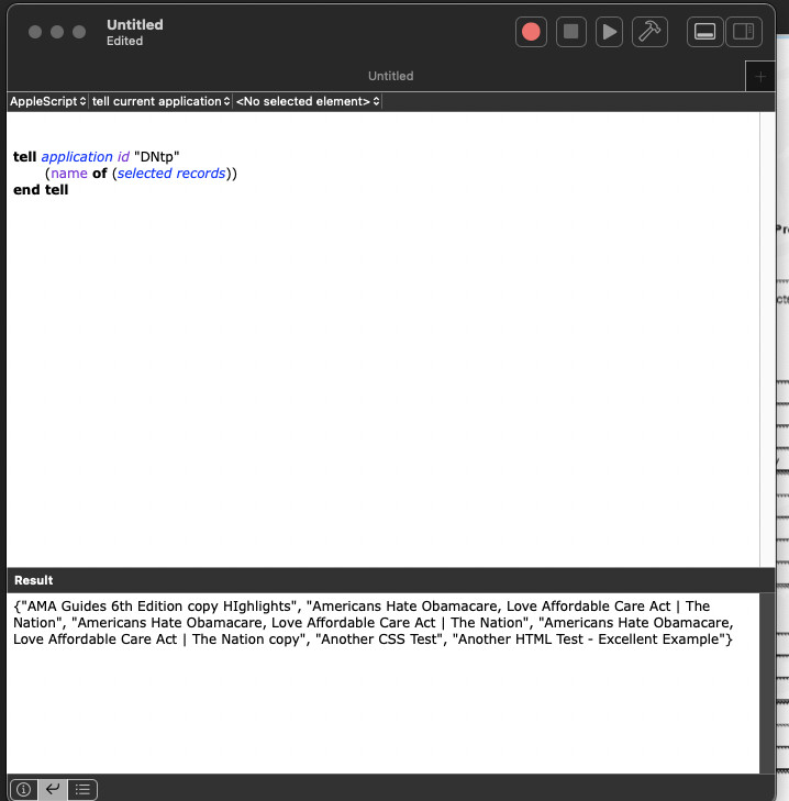

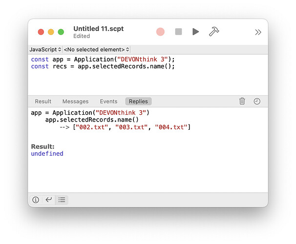

Actually, I was getting mostly undefined returns, however⌠running your code sample in Big SurâŚ
andâŚ
Maybe because the second script does not return a value at all?
Iâm saying the selectedRecords.name() is working, as you have shown (and I confirmed).
However, if youâre just processing selectedRecords() without the property, itâs returning undefined results.
So that leads me to think that from Appleâs perspective it âworks.â Arguably from DT3âs perspective too.
What can be different about my setup that is causing a different response that I can try to change? And why the problem with Javascript when the Applescript version works?

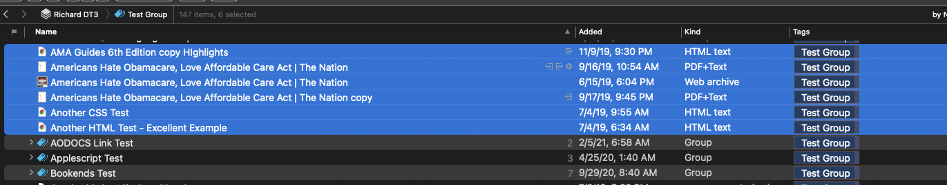

A screenshot of DEVONthinkâs window showing the selection might be useful.

Youâre using name where it should be name(). These parenthesis are not only meant to amuse @Blanc

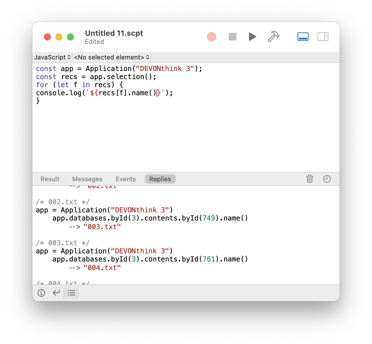

Hereâs an updateâŚ
Would you verify this on your side? Thanks!
Oops, I didnât verify anything. Just wanted to let you know that the code is fine (a bit awkward but correct and working)
Youâre more the JavaScript wizard than I by a long shot.
That type of JavaScript for loop is definitely new to me.
Any downside you see in that form?
You mean for n in ...? Well, itâs more what one would use to enumerate the properties of an object. For arrays, Iâd go with
array.forEach(element => {
// Do something with element here
Thatâs more in line with the other array functions like map, filter and reduce. Having a for in loop to get the âpropertiesâ of an array (which are just the indices anyway) and then use something like array[property] to get at the elements is a bit contrived.
