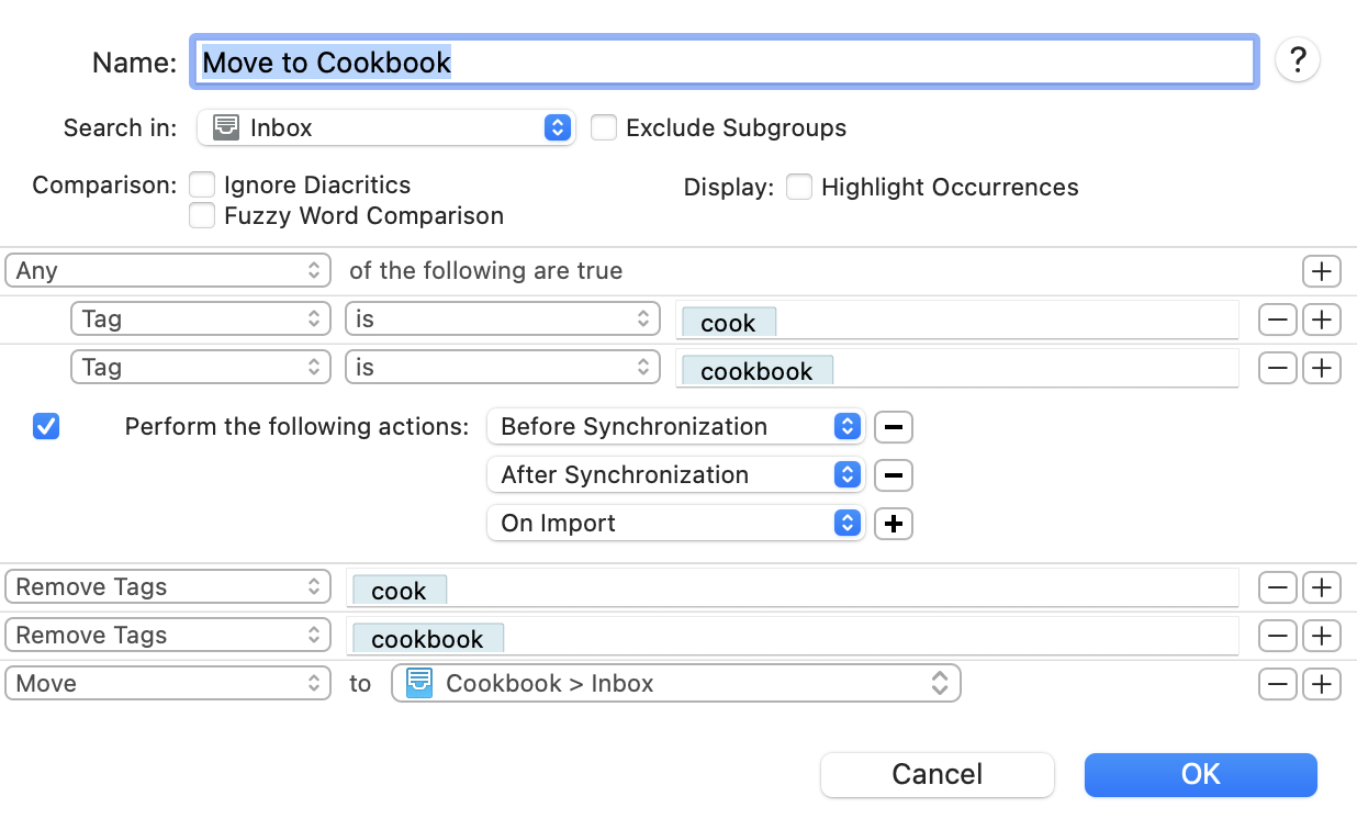

The Global Inbox is my clearing house
All new information, whether from my iPad in DTTG or DT on my MacBook, gets sent, shared or dragged into the Global Inbox. Smart rules based on a tag then move it into the Inbox of the appropriate database for processing when I am working in that ‘area’. I can add these simple tags in the sorter when clipping, when saving in finder, when sharing to DTTG, or in the Global inbox itself.
Simple Smart rules
Simple smart rules look for the simple tag and move the item into the correct database, deleting the tag as soon as it is moved. So tagging an item newsletter moves it to the Newsletter Inbox. Similarly, cookbook into Cookbook.
