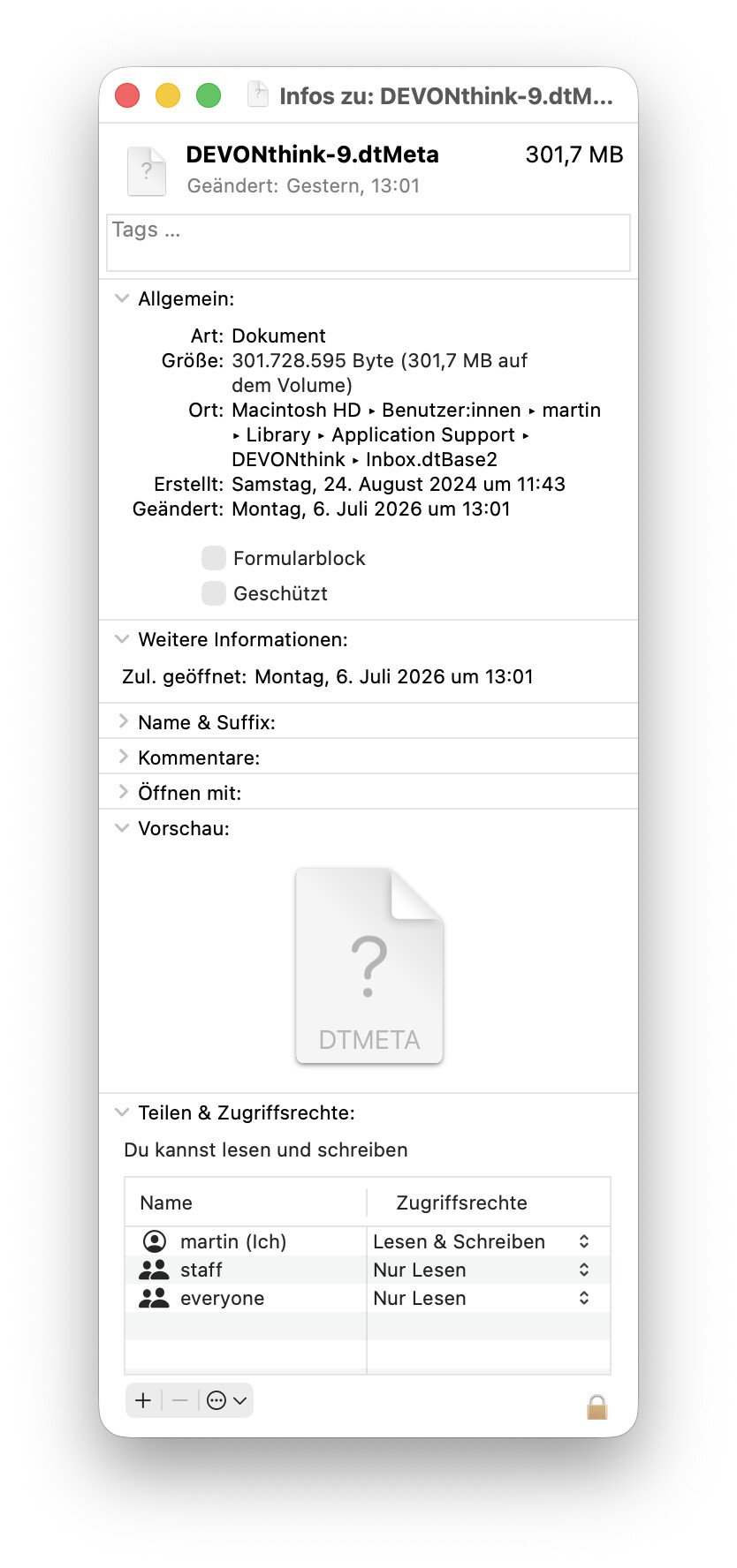

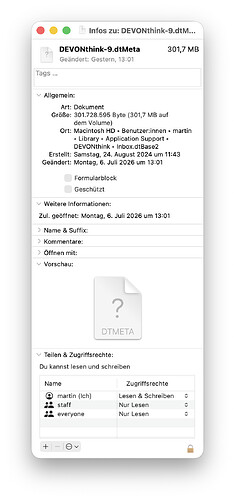

Are the file(s) “locked”? What are the macOS permissions on the file? Look in Finder.
Looks normal. Thanks for help :+1:t3:
