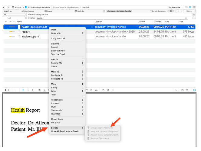

Thanks. That works! Except in search: I’m not able to select a script - greyed out. Is this a known issue?

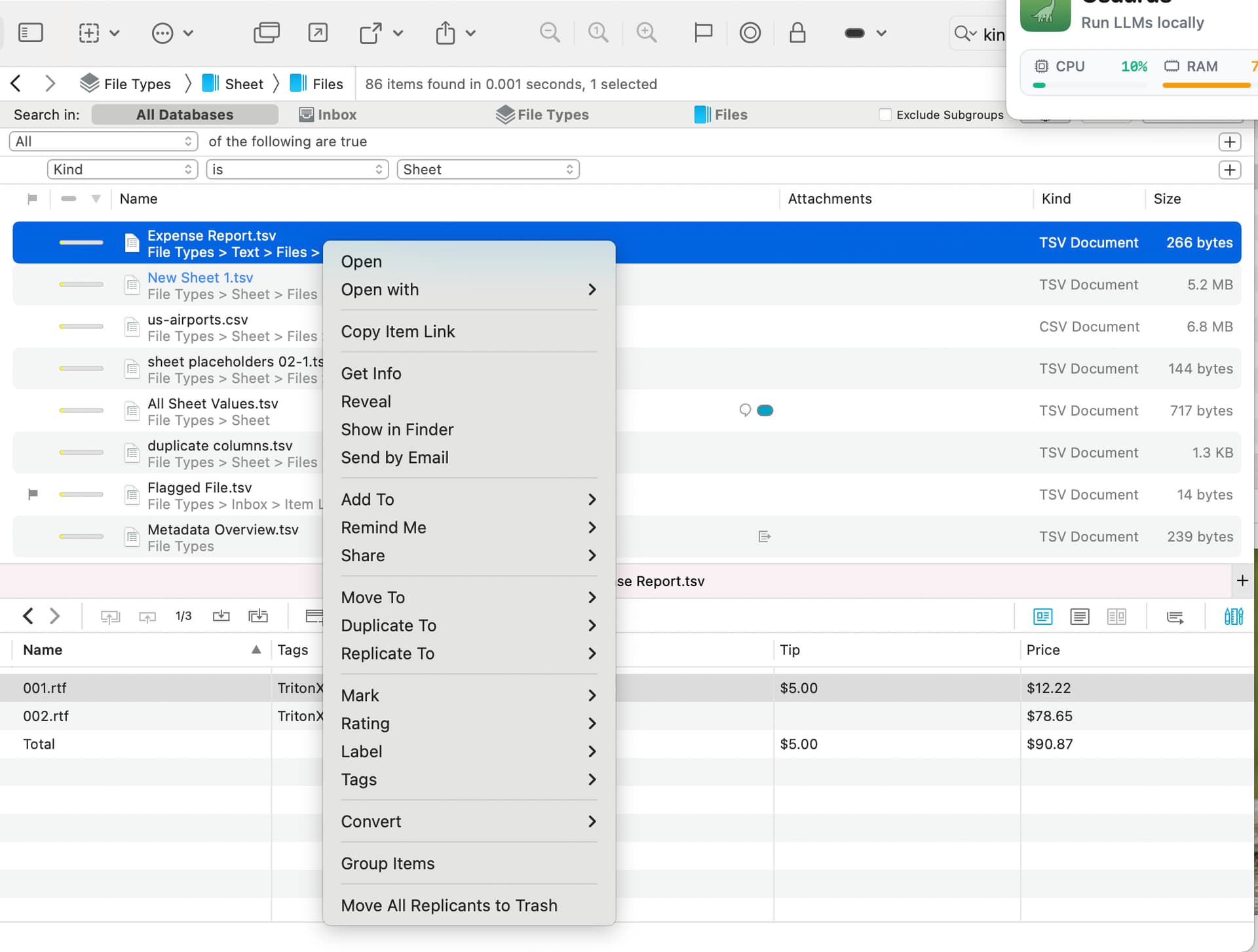

And the the Batch Process entry is missing although I can access it via Tools > Batch Process
Batch Processing isn’t available for search results though development would have to assess the behavior.
Considering the disabled scripts, if you already have a script running, you can’t launch another until the first is finished.
Ah! Ok. Yeah.

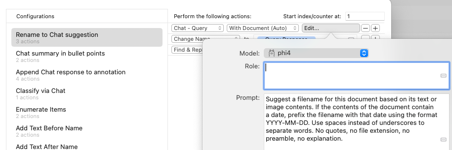

I created and started the Renaming Script as mentioned by @cgrunenberg earlier
It’s of course available. But smart rules & batch processing are blocked during the execution of a script.
How did you settle on phi4 ?

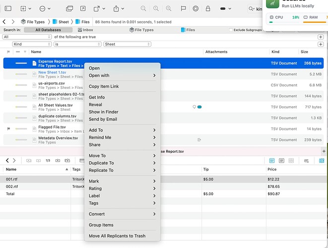

As per @MarvinMarvelouis’ comment, it can be run via the Tools menu or the hotkey but in the context menu of search results, Batch Processing isn’t shown as a command.
I didn’t know if that is intentional or not.
Trial and error. I ran different prompts on different models and chose the one with the best results.

That was a bit irritating; showing it “greyed out” would be more helpful - at least for me and more consistent with other menu entries.

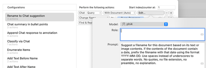

Did you use the same role & prompt?
If you use FastScripts as your script launcher then you can launch multiple simultaneous scripts. I have found it works fine with DT4 scripts.
I duplicated the existing one and pinned the model I think - I removed the entry an hour ago or so.
