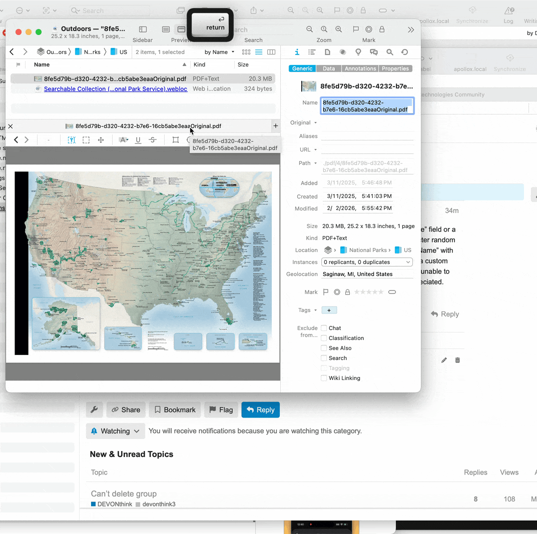

How do I retrieve the text in the “Title” field under the Inspector’s Properties and copy it to the “Name” field or a custom metadata field? I have ~20,000 pdf records I’ve imported and want to replace the 36-character random alphanumeric “Name” field with the data from Inspector→Properties→Title field. I can replace the “Name” with the “Title” one record at a time, but this is not realistic for 20,000 records. I can live with the data in a custom metadata field, too. The data also appears in the source pdf file when I use “get info”, but I’ve been unable to develop a script that will extract this data from either the Finder or DT4.2. ANy ideas would be appreciated.
Assuming this is a one-off activity, here’s a simple way, accessible to coders and non-coders alike…
  1. Select a known document.
  2. Select Tools > Batch Process > Batch Process or press Control-Command-B.
  3. Press plus (+) to create a new configuration and give it a reasonable name.
  4. Change the action to Change Name.
  5. Delete the Name placeholder and click the placeholder popup at the right end of the text field.
  6. Scroll down and select the Properties > Title placeholder.
  7. Press Apply and the name will be replaced by the title, if one is present.
  8. Grab a larger selection of documents, open the Batch Processing pane, and press Apply or Return.
rename-from-title

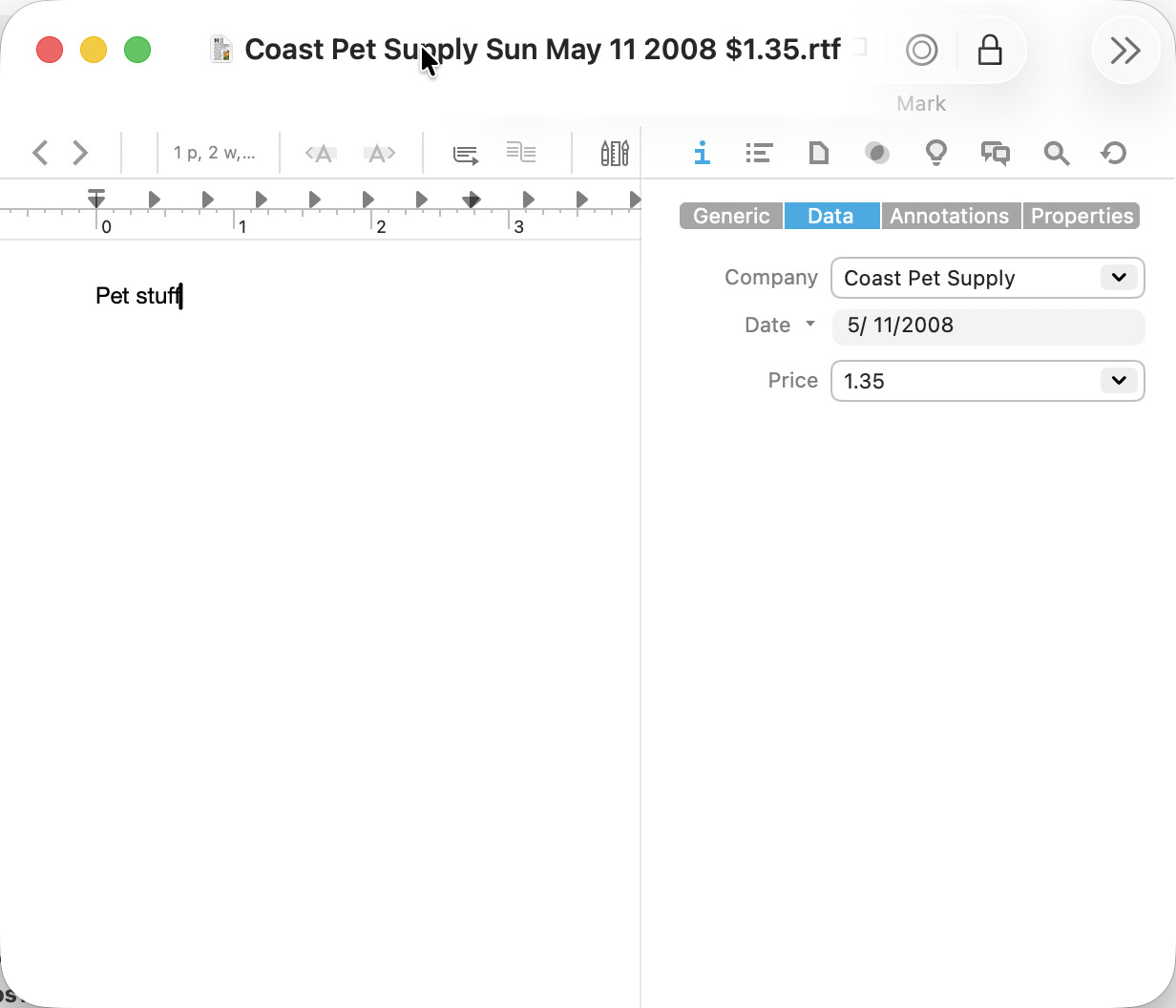

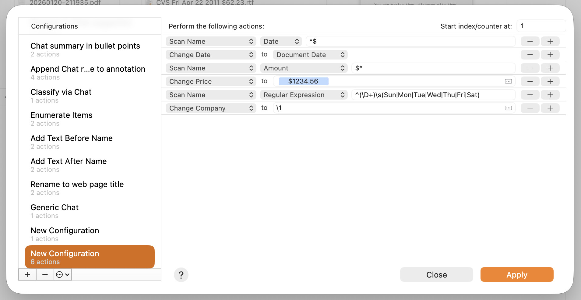

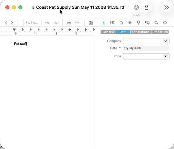

Yes, this is doable and honestly not very difficult for a layperson.
I made it slightly harder a task by capturing the company name as well.

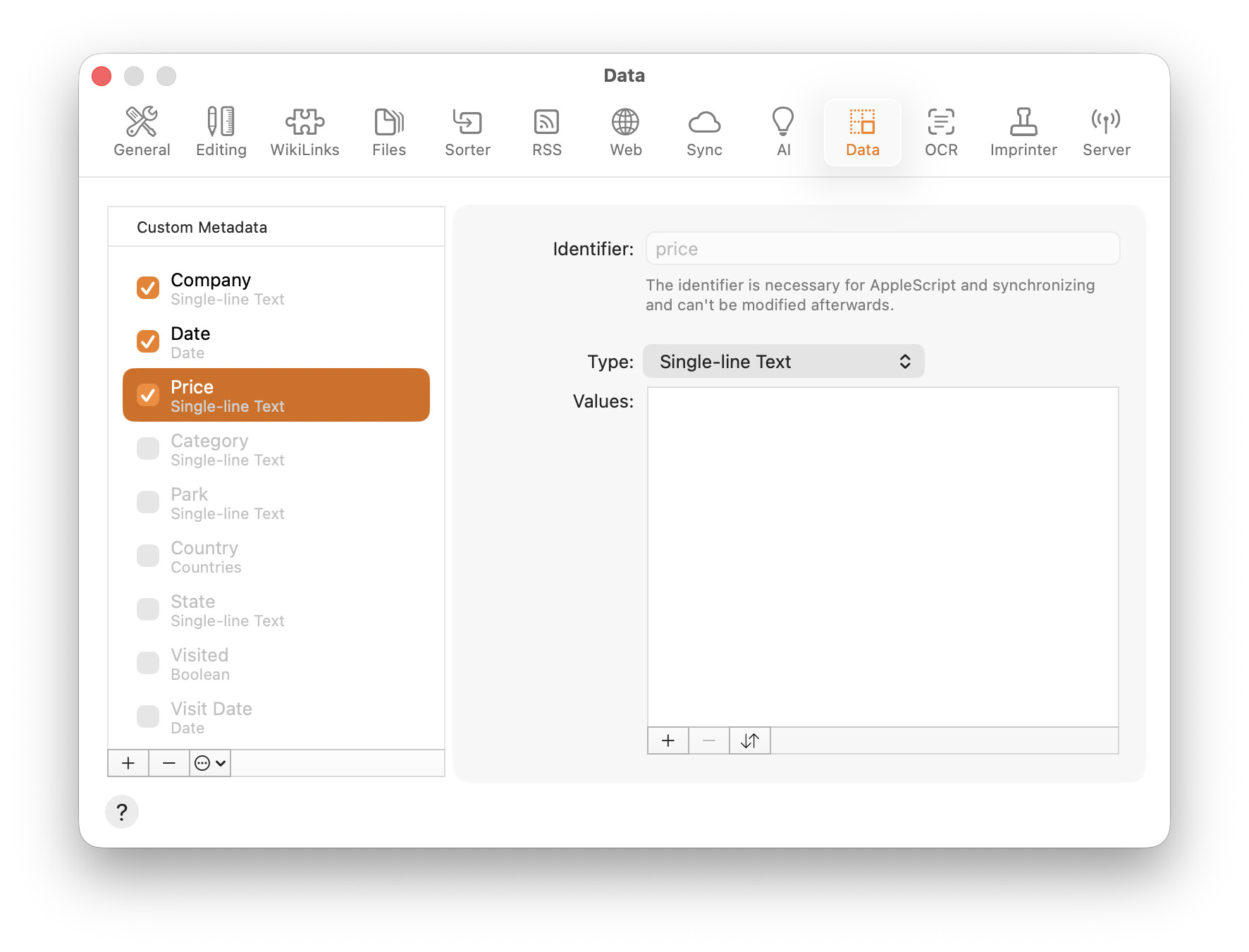

Custom metadata setup

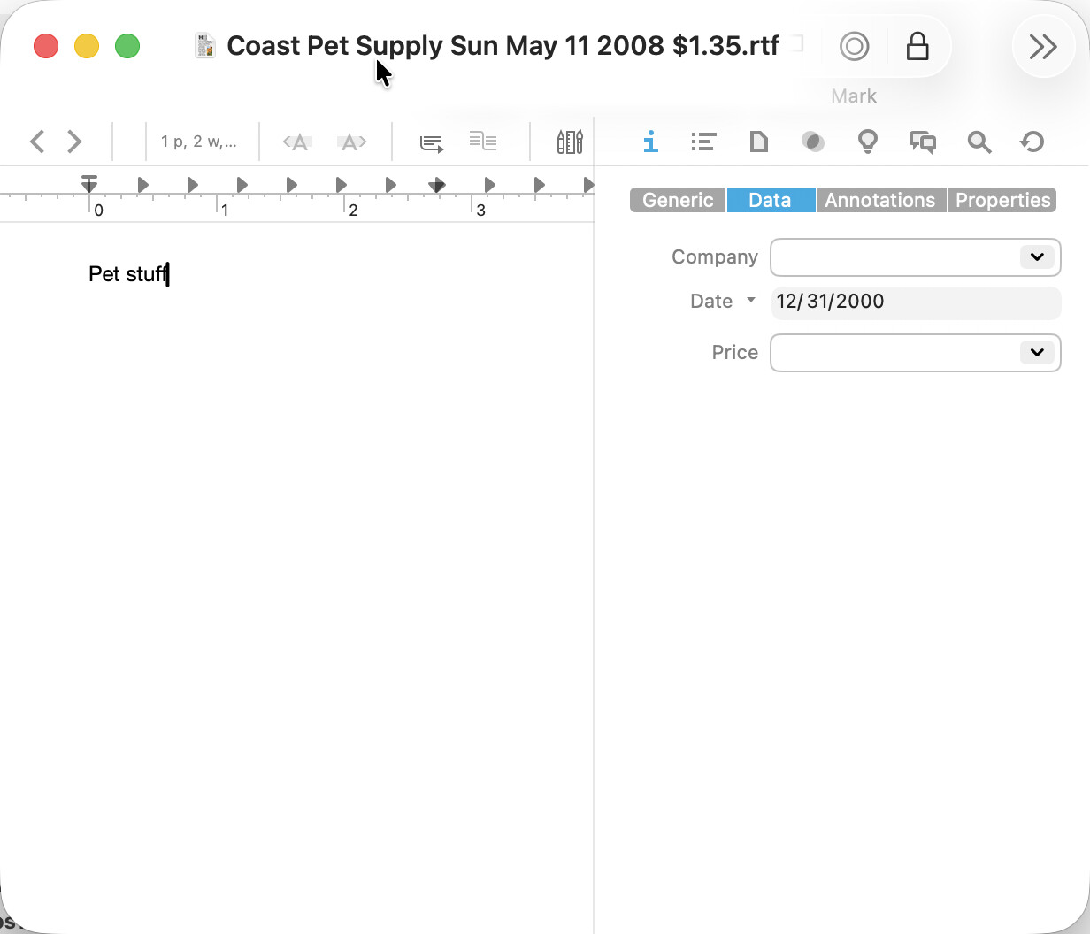

Original document

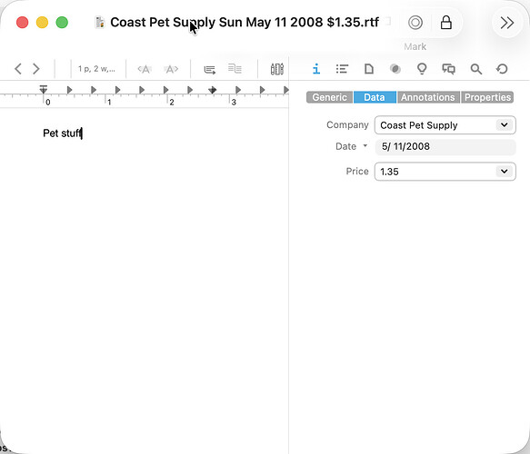

After batch processing

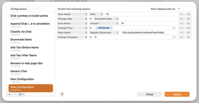

Batch processing configuration
  1. Scan Name looking for a Date in everything * preceding the dollar sign.
  2. Scan Name looking for an Amount in everything * following the dollar sign.
  3. Scan Name, starting from the beginning ^, matching everything that’s not a number \D, at least one occurrence + until it runs into a space followed by any of the abbreviated day names.
I included the regular expression (regex) option to (1) show an example of how it could be done and (2) how fragile it can be when working with limited data. Imagine you went to Century 21. That company name wouldn’t match since there’s a number in it. Are there ways to right better regex? Sure, but the point is it takes knowledge, testing, and good test data to craft effective ones.
In this case, a less fragile option could be ^([\w\d\s]+)\s(Sun|Mon|Tue|Wed|Thu|Fri|Sat) matching words, digits, and spaces.
Why not (.*)\s+(Sun|…)?
  1. To introduce some other more specific options, e.g., \w.
  2. Because .* is easy but very often too greedy to be useful. On a side note, I am usually inclined to .+ unless it’s something I know could have no occurrences, like spaces, \s*.
In general I am all for non-greedy ops. But here we want everything before the weekday. If the company name is AT& T or O‘Reilly, your RE will not match. .* or .+ will. And yes, the latter is better.
This seems to be working well; thanks again. I ended up using the “less fragile option”, which provided the flexibility of text strings with other characters.. I have only been using DT for a short time, having abandoned older software that is no longer supported. DT is quite a bit more flexible and powerful that they were (Paperless and Neat) and I’m hopeful, more long lasting.
