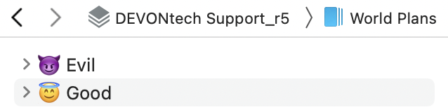

So I will try a rebuild on the base that has ghost dupes. I will also peel out about a quarter of my archives from DT, as DT is not a primary archival application, and after a long search, I’ve worked out better ways hopefully to horde my data, and leave DT for my evil, evil plans.
Thank you for the input.
Oh, I meant my small, totally innocuous plans. I have other apps for the evil stuff.
