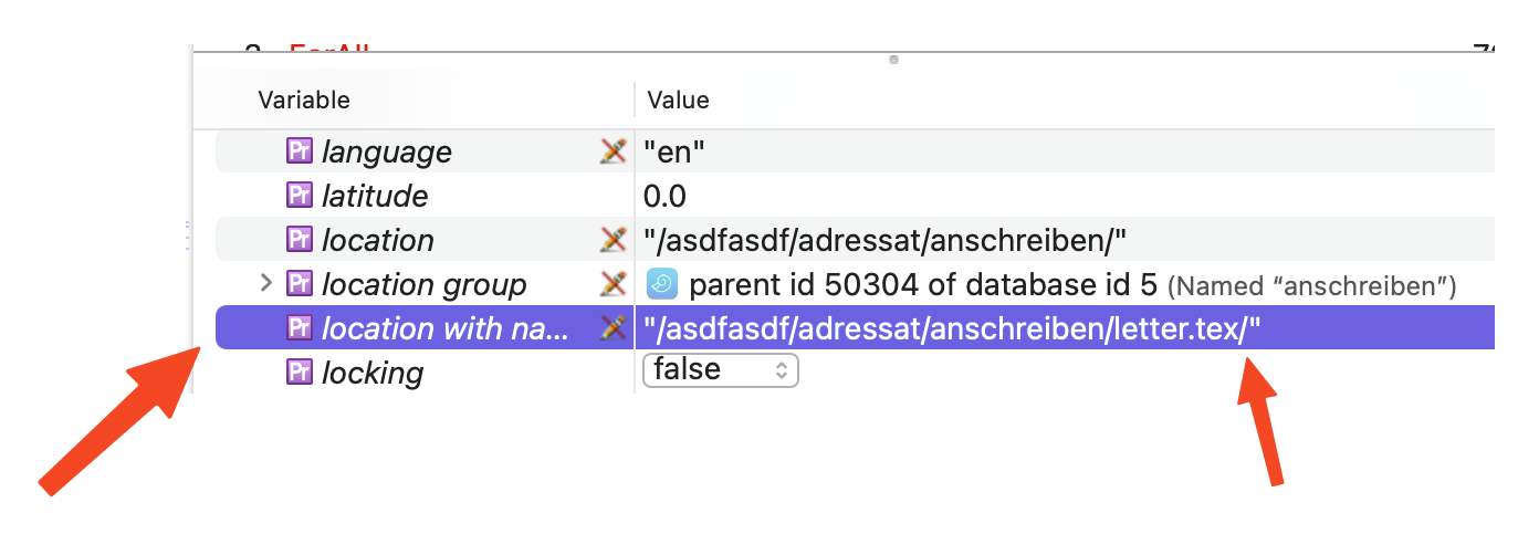

I just stumbled across this while writing an AppleScript to generate PDF files based on LaTeX sources stored within DT.

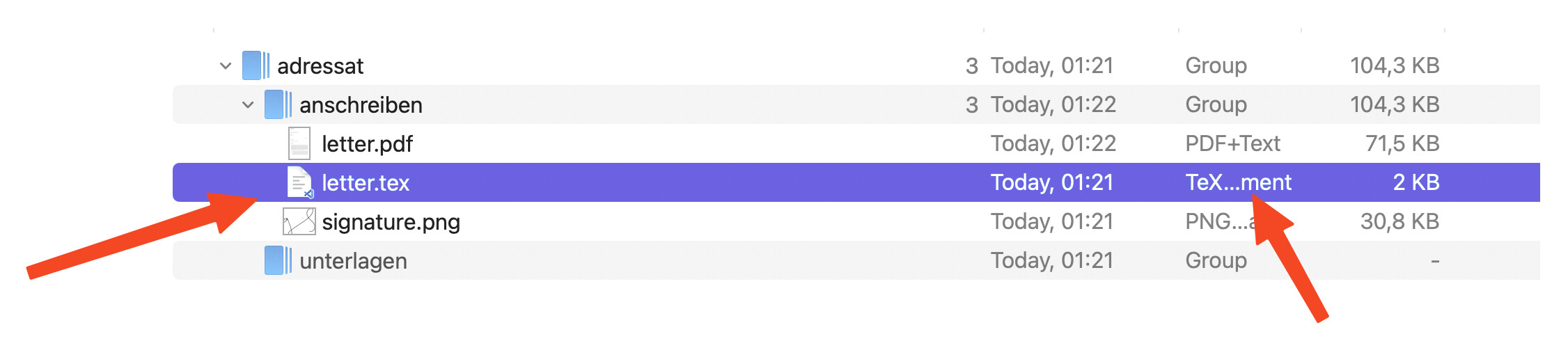

Is this “works as designed”? I did not expect that there is a trailing slash behind letter.tex.
Sorry, if this text looks auto generated, but I have my newborn on my lap and use dictation.
The selected record is a LaTeX source file.
I confirmed this is the case for documents but it would be the appropriate result if you had a group selected.
Development would have to weigh in on it.
At least for DEVONthink the trailing slashes do not matter at all, it works with or without.
