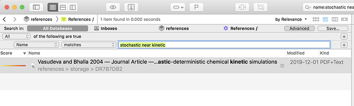

Notice the name of the file that is the first result above. Now if I change the search to search in Name, I get an unexpected result:
The top result from the first search does not even appear in this result, even though I’m searching in the name field, where you can see the original search results contained the highlighted words.

I was wrong in my addendum, about the behavior following the FileRebuild database operation. The behavior did not change. The mistake I made was that I used the singular form of a word I was searching for (“kinetic”) instead of the plural (“kinetics”) as I had done in the original search. When I repeat the actual original search, I get the same results – having rebuilt the database did not reduce the number of results I get.

Note: When you’re constructing your search, if Partial matches while typing is enabed under the magnifying glass, a wildcard asterisk is assumed at the end of the last term. This means kinetic would be treated as kinetic*, that is until Return is pressed. Once you press Return the wildcard is discarded and the final term is treated as a word. However, adding the asterisk explicitly would allow you to retain the flexible search as long as you’re using a matches criterion.
