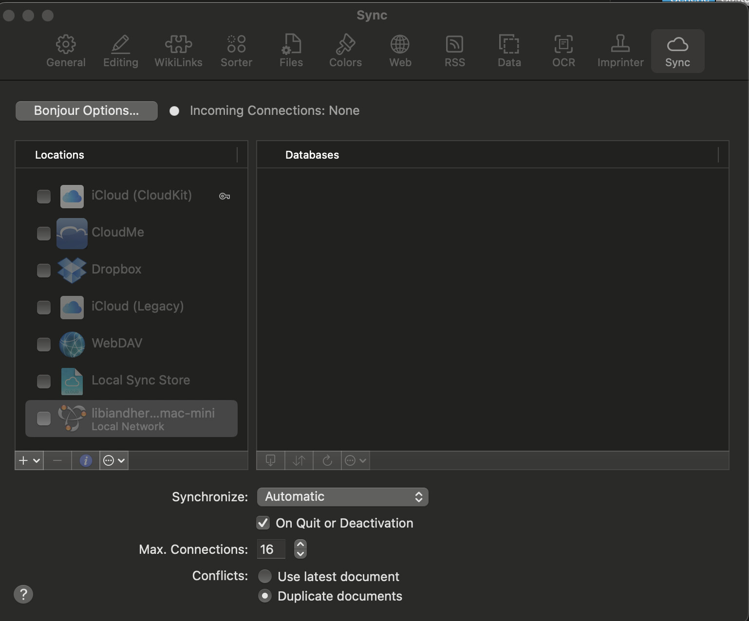

Since posting, I’ve cleared the Port number on both computers. The MacMini locations does show on the MBAir, but it will not allow me to check the box next to it. The MBAir location does show up on my MacMini but insofar as I know, I should not check the box next to it. On the MBAir, Cloud Kit is available, every other option is grayed out

It looks like this the screen shot is from the device that you have defined with Bonjour “accept incoming” as on?
